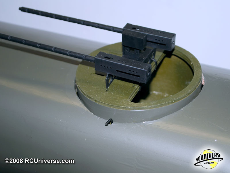

Well, we’re in the home stretch on finishing up the Top Turret add-on. Where we are at now is the time to double check the operation of the turret drive unit and make sure that everything works properly. If there is anything that needs adjusted now is the time to take care of it. The instructions at this point state that if desired the inside of the fuselage could be painted. If it was needed I would have done that, but I really wanted to avoid the hassle of doing that if I could. I was able to cut the hole for the top turret pretty tight and it’s difficult to see any of the wood from inside the fuselage when the turret is in place. Because of that I decided to not paint the inside of the fuselage.

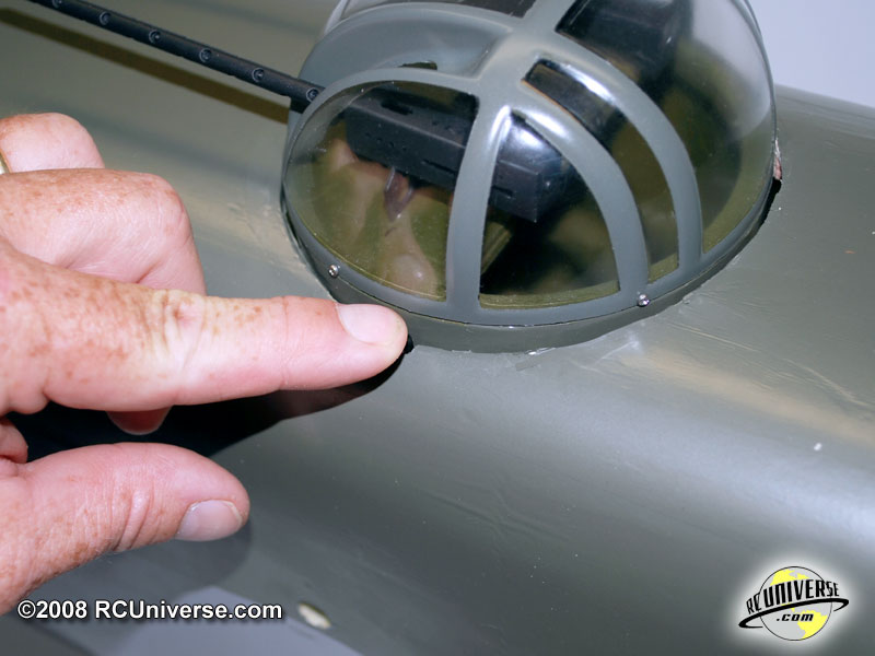

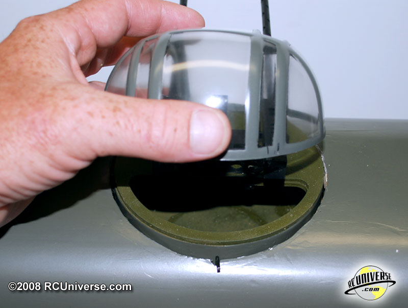

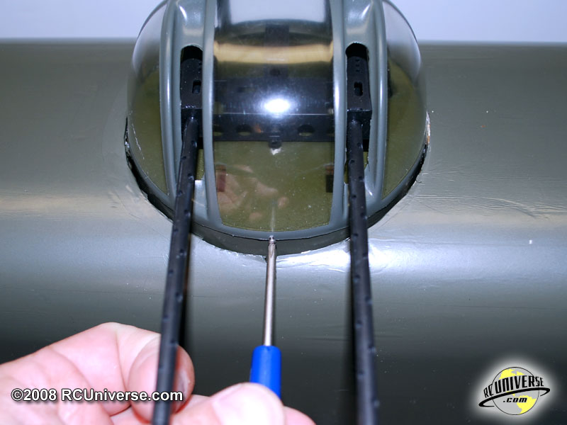

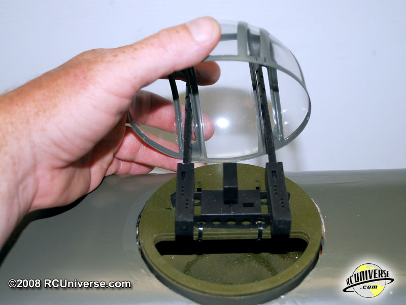

Then last step in the installation is to secure the turret to the drive unit and install the canopy on the turret cylinder. Place the turret on the drive unit output shaft, making sure to seat the drive disk of the cylinder on the shaft. A small sheet metal screw is then used to secure the cylinder to the drive unit. To install the screw it is place in the hole in the bottom of the cylinder floor (this is why I indicated to leave the turret canopy off in the last step). Use a screwdriver to tighten the screw to secure the cylinder. Now the canopy can be installed. Feed the gun barrels through the slots in the canopy and then seat the canopy on the turret cylinder. Use the 5 #0 x 1/8” pan head screws to secure the canopy to the cylinder. And that’s it; the Top Turret Assembly is completed.

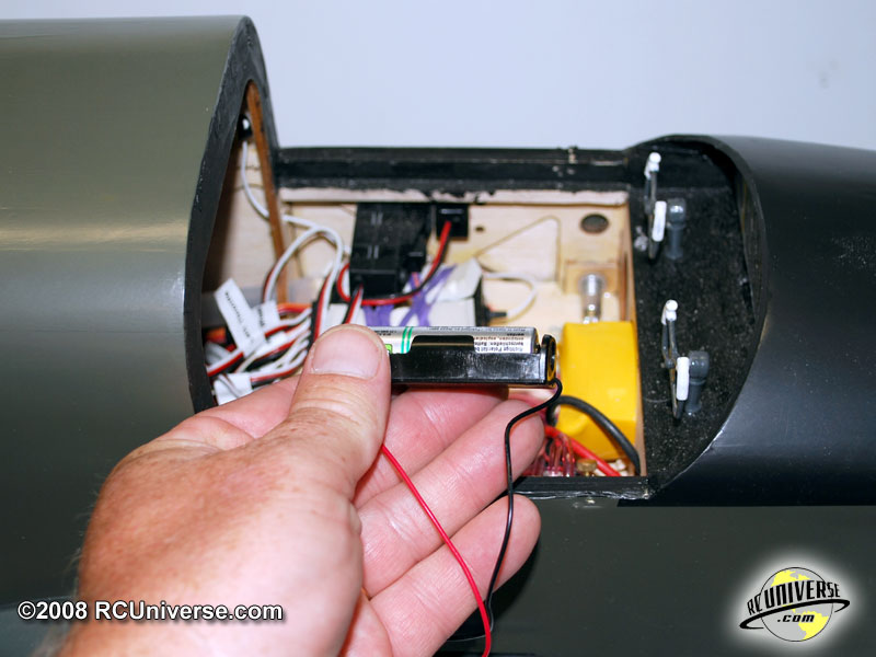

One last item to mention here. I did not talk about the battery for the drive unit. I did not install it at this time for a reason. I want to install the battery in an area that will be easy to put a battery in to the battery holder. It’s not good to leave batteries installed like this if not in use and I want to make it easy to get to, as well as easy to install the battery when it’s time to fly. I didn’t want to have to take apart parts of the plane in order to access the battery. Because of this I have decided to install the battery above the bomb bay when I get to that installation. This way it’s a simple matter of opening the bomb bay to access the drive battery for the Top Turret. But if a bomb bay is not being installed the battery can easily be installed under the cockpit floor, inside the nose gunner canopy, or another spot I had considered for the installation was inside the front landing gear bay. So there are options for where this battery can be installed.

1. Install the cylinder on the drive unit.
2. Sheet metal screw used to secure the cylinder to the drive unit.
3. Tighten the screw.
4. Feed the gun barrels through the slots in the canopy.
5. Place the canopy on the cylinder.
6. Install the small pan screws to secure the canopy in place.

9. The drive battery will be installed in the bomb bay later on.
