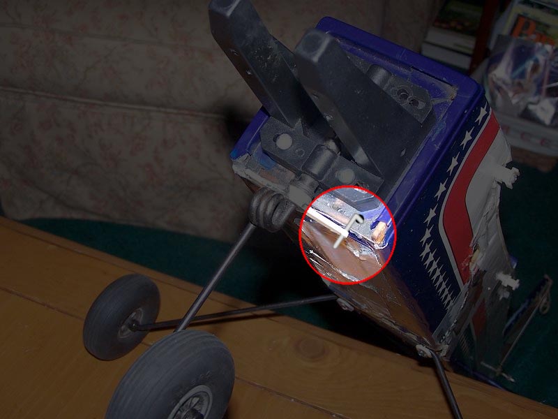

Just drill a hole in the firewall and run a wire with a 90 degree bend through the hole to the rudder servo (You may have to drill the opposite side to what I have shown here)
