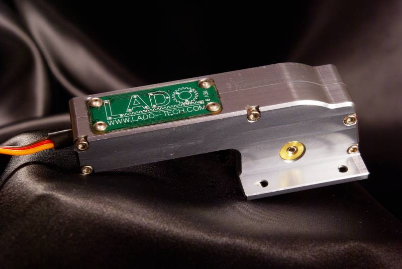

The Aero-Modeler traditionally had two choices for their models if they needed retractable landing gear. Pneumatic air and servo assisted mechanical retracts. Now our third choice is electric.
LADO Technologies has developed an extensive line of electric retracts. For this review, I will be critiquing the 60 sized, 85 degree drop in replacements for Hanger 9 planes.
First impressions:
When I opened the box of my first 2 LADO retracts, my first thought was that of incredible craftsmanship. The outside casing is machined from two blocks of aluminum that fit together with pin point precision. The control circuit board is integrated into the bottom of each retract. The lead wire has a universal connector of high quality with a custom rubber seal to hold them in place. Located on the inside of the brass pivot stud, are stainless steel setscrews for fastening the strut. On the top side of the retract units is an adequately thick mounting plate with countersunk holes for screwing your retract to your wing mounts. The casings and circuit board are held together with high quality socket head cap screws. As the units come shipped with the mechanism set at a 45 degree angle for testing before they leave the factory, the brass jackscrew can be seen from the opening. This model retract can be ordered with 5/32 or 3/16 opening for your struts. In my opinion, a well built piece of equipment.
Installation:
Installing the LADO retracts are very straight forward. Fit them to your wing with your strut trimmed and aligned and screw them down. Join the lead wires with a Y adaptor and plug the end into your channel 5 pins on your receiver. Turn on your transmitter and receiver and flip the switch. The units are powered by the receiver. The LADO’s come to life with a sweet motor sound, then a forceful locking sound can be heard as the built in motors labor slightly. Current draw is .3 Amps during movement and .5 Amps for about 1/4 second during locking. Movement is slow compared to mechanical or air retracts. Using a regulator set to 6 volts, it took about 6 seconds for them to fully deploy. Great for modelers that want realistic retract speed. You can even purchase an accessory board to replace your Y adaptor that will stagger the retracts for even more realism.
Practical operation:
I installed my LADO’s in a 9 pound War Bird with 3/16 spring struts. Simply put, they work flawlessly. I start to retract the gear right after the first turn after liftoff so I can watch the gear slowly tuck under the wing as the plane is flying level above the runway. What a joy to watch! I do the same for landing as well. Special attention should be paid for landing. It is going to take around 6 or 7 seconds for the retract gear to lock down so plan ahead to avoid any mishaps. On landing, the retracts are solid. Not a single budge.
Durability:
I can not say I have had hundreds of flights using these retracts. I will however share an experience. On my maiden flight of my War Bird, one of the struts got a tad bent on landing. Since I had blocked my gear mount bay with bass and plywood I figured it would be alright to try to bend the strut back without taking out the retract or causing any damage to the wing. I retracted the gear till the strut was about at 10 degrees to the wing and turned off the receiver to stop the retracts from further travel. I then grabbed the wheel and tugged till the strut was strait again. After that I cycled the retracts several times to be sure they would be fine. Not a single problem then, or ever since. From that experience, I am convinced the durability of these units is far more than need be.
Maintenance:
According to the manufacturer this model may need a little light machine oil after 2 years.
Overall conclusion:
If you want worry free retracts this is the way to go. Imagine not having to worry about a stalled servo, bent rods, having to pump air into your system or concern yourself about a loose air line. LADO retracts are built with the highest quality standards for years of service.
