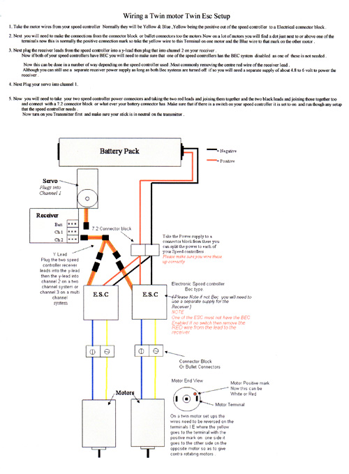

ORIGINAL: windfou
Hi everyone ,
i am not so good in electronic and i need some help ! can someone can send me a link please with a diagram so i can see how to plug my two esc with one battery.
my set up is 2 motor ,1 brushless esc for each motor , and 1 battery 11.1 lipo 3s ( For the receiver i need a y connector i thing)
so thanks to read my post and i hope someone can tell me the safest way to do it.
Here is a useful diagram - for brushed motors but that makes no difference.
