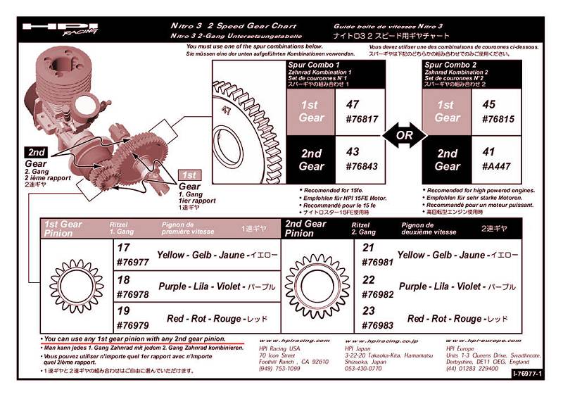

Now the last thing I want to do is sound like a smart *****, I appreciate all the info very much BUT, the pinion gears for the RS4 2 speed are not like the gears on other cars. All the first gears and all the second gears are the same diameter. I know what you are thinking. NOW CAN THAT HAPPEN?? Creative tooth spacing makes this happen. The gears with more teeth have narrower teeth then on gears with fewer teeth. I only found out about this one night while playing with some gear ratios for this car. I also found it in the gear chart from HPI. It states “You can use any 1st gear pinion with any 2nd gear pinion”.
But I am still worried that this lower ratio will break more parts. Now today I got a chance to try the new gears and had no problem. I DO like the higher speeds and the motor has no problem pulling it.
