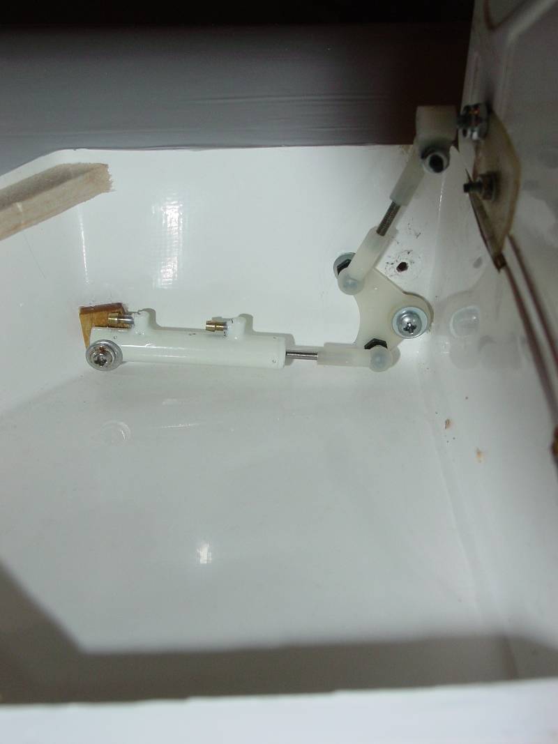

Mount the bell crank short side down right in the corner where it can swing close but not touch anything. I epoxied the bearing and used a wood screw to install it bellcrank. Make sure you cut off the tails of the ball links so they won't rub. Make minor adjustments to allow clearance and full extension and retraction of the shaft on the air ram.
