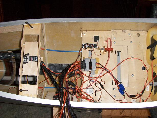

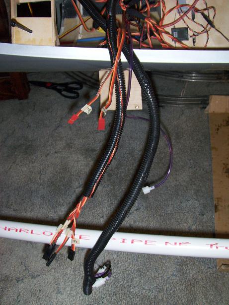

pic 1-4:
While watching Battle of Brittan, I made up two Y's and six extensions using 20 gauge wire.
Amazing how much wire is needed: I've used well over 50' of 3-line wire.
pic 5:
All wires are now connected to the receiver.
Throttle
Ailerons
Elevator
Rudder
Gear
Flaps
Canopy
Choke and cowl flaps
Wing fold
binding
two batteries
one on/off switch.
pic 6:
Internal wires in fuse still need organizing.
I got some of the wires/air lines bundled.
Those wires going to the wing:
on/off for pump (wing fold)
Flaps
Ailerons
Gear
Wing fold (servo)
Air lines going to wing:
tail gear
tail gear doors
Main fill/pressure gauge.
pic 7:
Wires from the wing still need bundling plus tail gear air lines.
