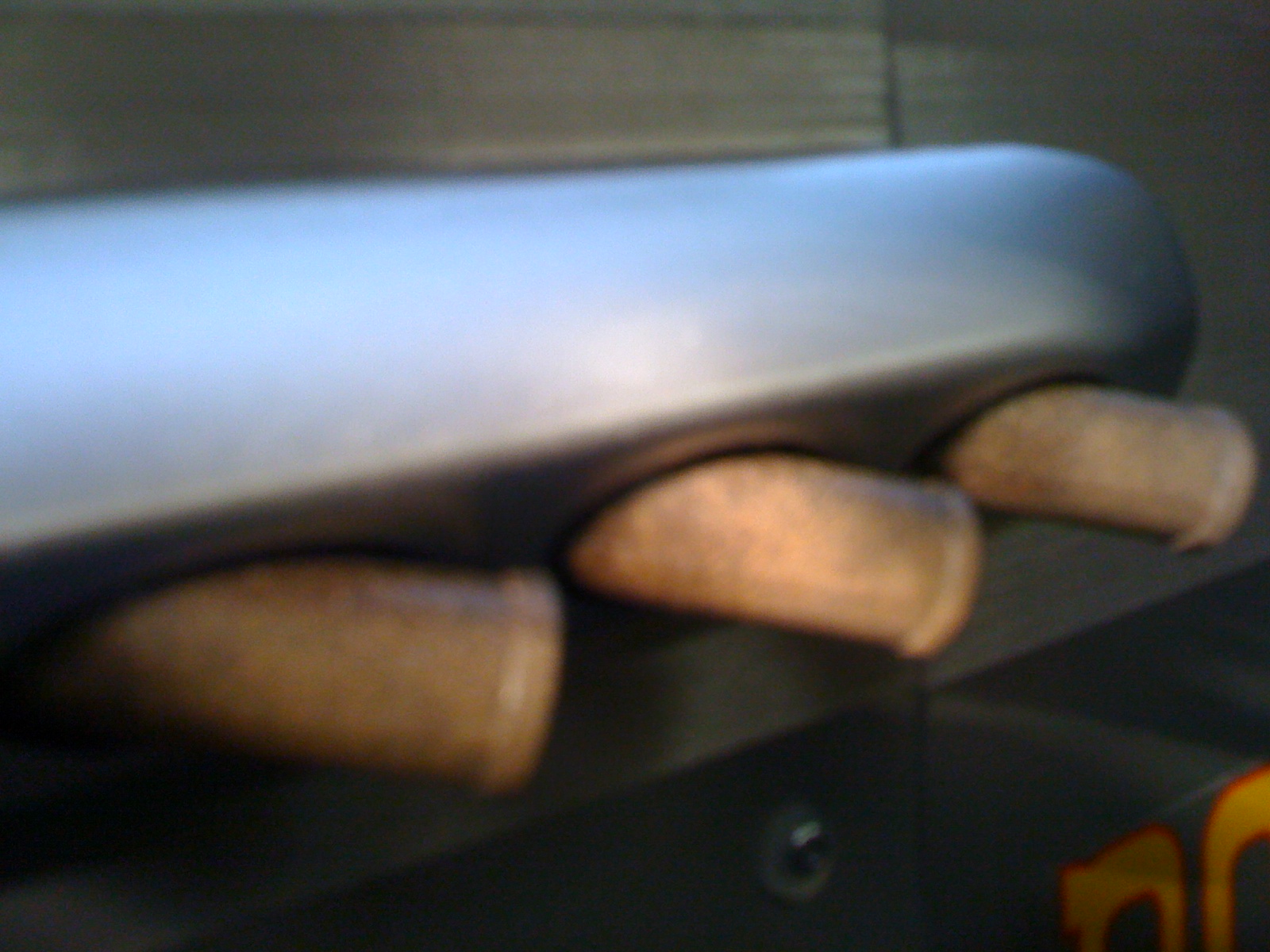

Here are a few photos o some modifications to my Mustang Ihave been working on to include a picture of the Rolls Royce decals installed. ( have obtained quite a few more of these incidentally in case anyone is interested. Here is the link to my ad: www.rcuniverse.com/market/item.cfm?itemid=584473&electric=0
1. Recovered fuselage from dorsal forward
2. Installed new cowling from Fiberglass Specialties and faired to fuselage.
3. Installed the "Tony Howard Suite" ie exhaust and air filter covers
4. Built a home made gun sight
5. Installed air pressure guage in one of the rear radio boxes behind pilot's seat
6. Removed the Slimline Pitts muffler and installed a J'Tec muffler to fit completely inside of cowling. They make a very nice product for our airplanes. Incidentally, it is mated to a Zenoah G45.
7. Added Flite Metal to the area behind the scale exhaust and aft of it to reproduce the stainless steel version on the full scale model
8. Installed new Sullivan 32 oz fuel and replumbed lines for less of a headache.
9. Added servo operated kill switch
10. Installed new O-rings in all of the Robart air cylinder and valve components
11. Will install the new P-51 Nomenclature decals from Pro Markwww.pro-mark.com . A very complete set of just about every stencil on the airplane.
She is turning into a much nicer airplane with all of the above additions and can't wait to fly her in the Spring!
