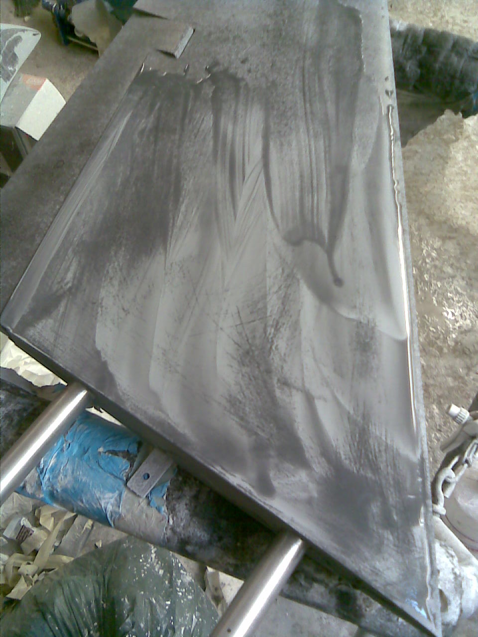

Picture 1. Begin by spraying a light coat of guide coat on your model. Guide coat is a thin paint that is designed specifically to contrast the existing color of the surface you will be working on. In this case, I am using PPG Guide coat in a rattle can. Don't worry about getting even coverage, the guide coat is there to show you low spots, sanding scratches, imperfections etc.

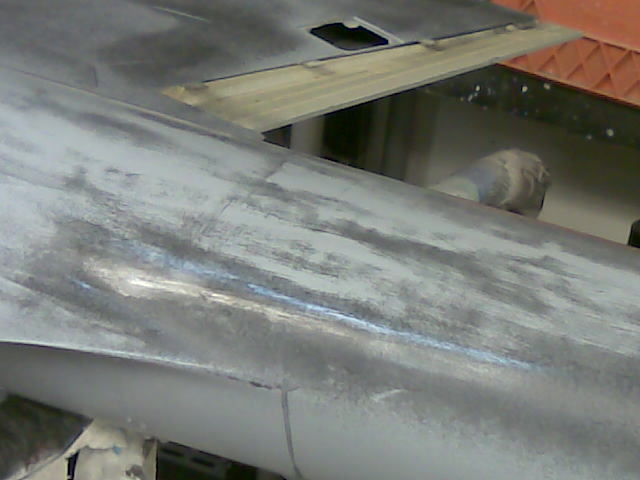

Picture 2. Begin sanding with your 800 grit paper. Sand first in one direction, then 90 degrees to that first direction. Try to avoid the urge to sand in circles and if you see an area that is low, or has a very deep scratch, avoid the urge to use pressure in just that small area. Sand over a large area until the area blocks out. If you put pressure in just one small area, you will just sand a low spot in that will show up very badly in your final clear.
Picture 3. Almost immediately you can start to see the sanding scratches or any blemishes that might have been in the surface. These lines will all show in the final clear and worse yet, if you spray a metallic or pearl, they will show 10X worse in that paint as the flake will lay funny in the scratches and reflect the scratch itself. Use your squeegee (or paper towel) to wipe the surface continually so you can see how your sanding is going. You want the scratches to disappear completely.
Picture 4. Once the area you are sanding has no more guide coat showing, move on and do another section.
