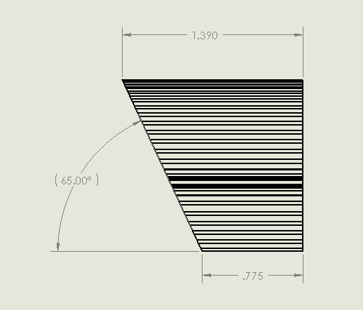

Here are some CAD images ofthe ACC3929heatsink on an EFLite 6-series 2700kv motor and how to mod it to fit on my mount.
If anyone needs dimensional help with their heat sink let me know and Ican help if you give me the overall length of the motor(dimension "F" on this worksheet)and what mount you are using.
Gary
