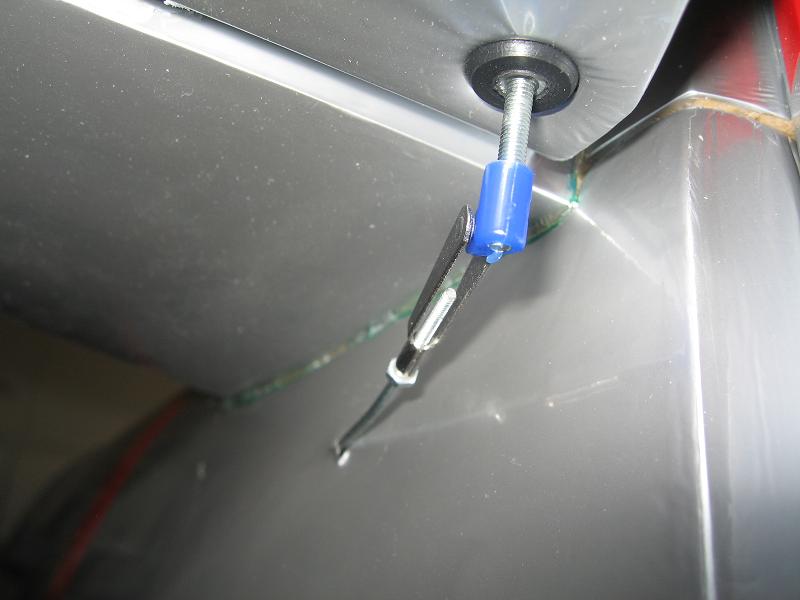

Today i did some reinforcing ....
Mainly on the area behind the firewall .... and also on the wing.
Where the retracts will bolt on....
I used thinned epoxy (30'+alcohol) and fiberglass cloth!
I have also done the install of the control horns on the elevators and rudder.
Now the jobs that have to be done,
are :
1) retracts
2) servos on the fuselage for the elevators+rudder+throttle
3)installation of my Saito 120S (...waiting to come)
4)batteries/Rx/fuel tank & miscelaneous hardware!
