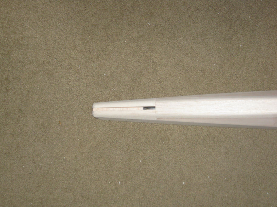

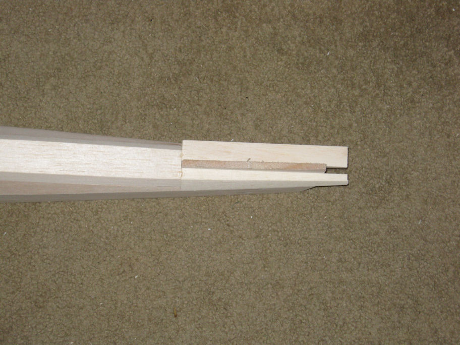

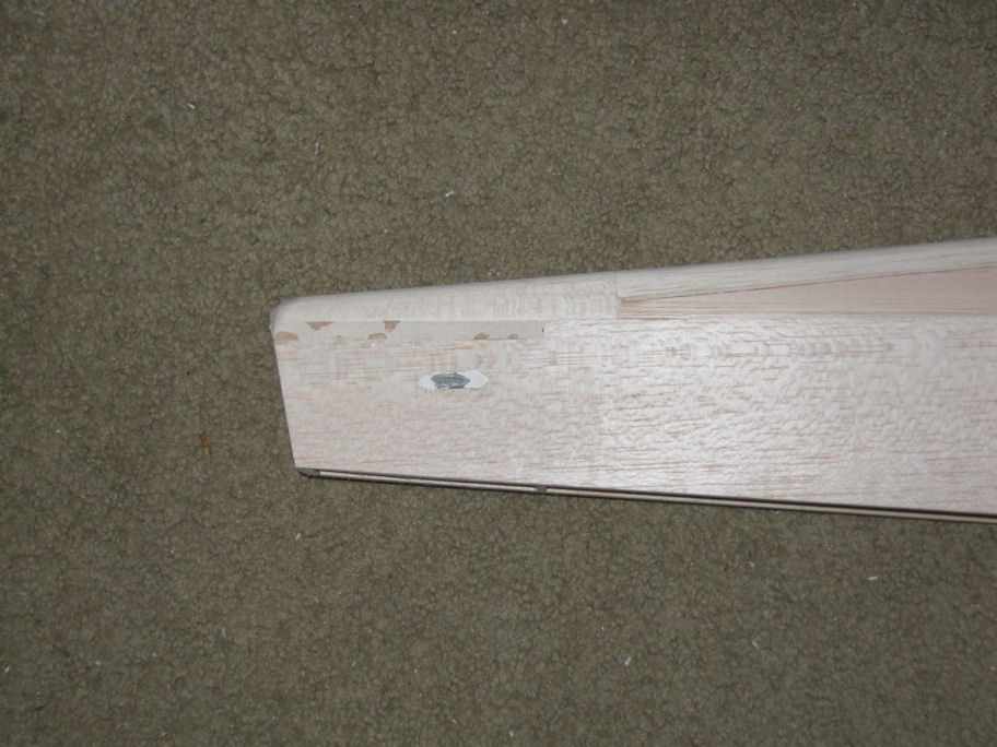

As for the Smoothie build, I've really just been doing a little sanding. I found a low spot in the side of my turtle deck. Evidently I was a little aggressive with my sanding and my reward was adding some spackling to fill a low spot. I also skipped forward in the plans a little and sanded down the tail filler blocks.
I like to build my kits so that end up going together like an ARF after all the components are covered. So, I used scrap balsa and tacked spacers where the horizontal and vertical stabs would be (that way I can shape them and not worry about nicking the stabs), and then tack glued the blocks in place for shaping. I also used this time to fill around my pushrod exits as needed.
