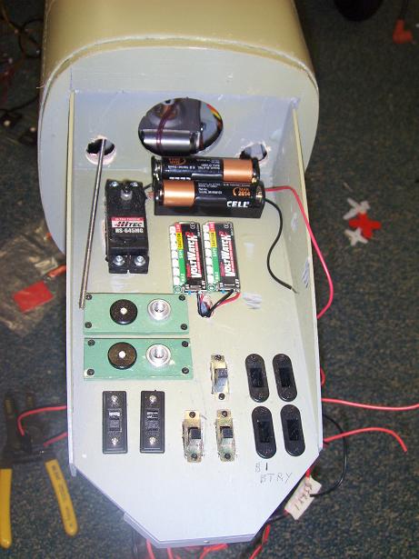

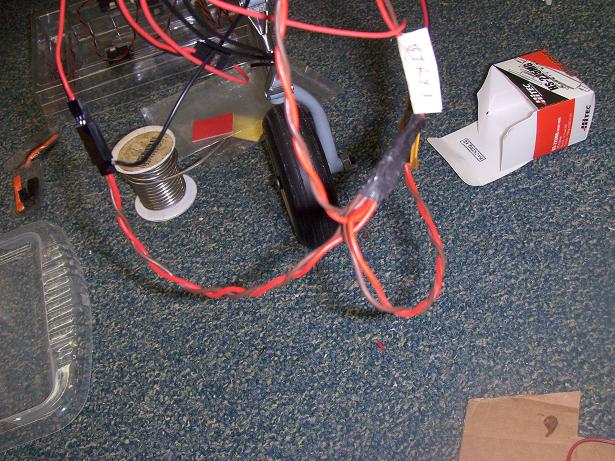

I like to adjust each servo as it's installed so one power safe receiver was connected with one battery pack (so far).
For the battery pack, a 3-way 'Y' was made for the battery, charging jack and voltwatch.
Besides, probably saving a lot of money on extensions, making my own gives me the exact length that I need.
The nose steering servo extension, soft switch extension (on/off) and a binding extension were also made.
20 gauge wire is being used on all extensions that go to servos.
pic 1:
The 3-way needed two female and one male plug on one end.
pic 2:
The 'receiver' was 'binded'.
The new power safe receivers no longer have the little blue lights on each side and the LED's are different in each remote receiver (hopefully, new and improved).
pic 3:
The nav/landing light batteries (two AAA's) were installed and two voltwatch's (I like visual confirmation of my battery's condition).
