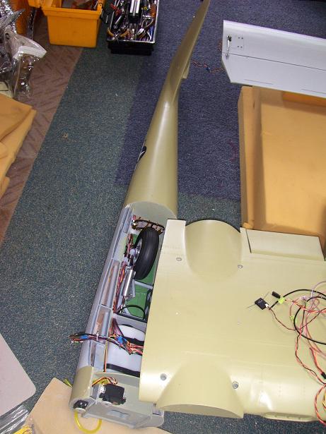

I secured the left boom to the center wing and transmitter tested all electrical and manual test of all air hoses and labeled all air hoses for up/down, close/open, etc. Hopefully, my UP-3 valve will come in this week (wonder if it's possible to use a UP-2 valve as a UP-3 since I have two of those!).
As with the right side of the center wing, a new hole was drilled in the right side and five air lines and five sets of wires were routed through the hole.

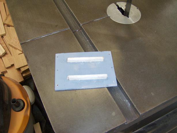

Made some rudder servo covers from old P-51 covers.

I pulled all five wires at once through the right side of the center wing for the right boom.

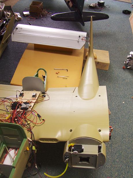

pic 7:
RATS NEST (scale wise, there must be the same amount of wire as in the full size!).
Glad all that is going through two receivers!
One reverser Y needed for the nose.
