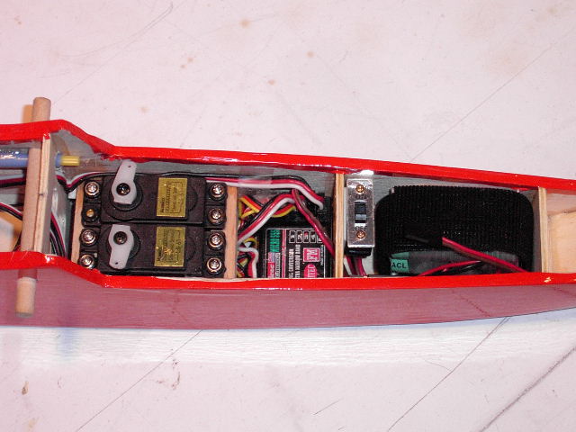

Since the nose needed ballast anyway I replaced the soft balsa nose block with doug fir. Harder to shape but I have the carpentry tools. No dents from landing hard. I made a little hatch for the lead compartment that screws into the nose block. This allows adjustment to the amount of lead later. Don't sweat the details or think a perfected model is going to make a lot of difference at this stage. Get lots of flights. Try some slope soaring in gentle conditions if you have a slope nearby. Getting to fly half-an-hour at a time is addictive! best wishes!
Very nice.
Looks like HS-81s for R/E.
Did you have to put lead in the nose to get it to balance? If you did, and you want to take some weight out you might consider moving those servos forward of the bolt. I did that on mine and saved some weight.
What is your all-up final weight?

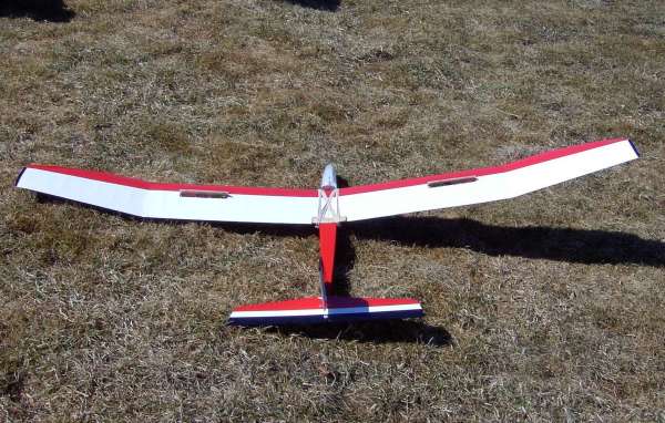

Hello Everyone,
Discovered this thread and enjoyed reading it all.
I built a Spectra which is the electric powered version of the Spirit ( info for who may not have known ).
It was highly modified. I added 1 1/4" to the wing chord and made some flaps and ailerons. I also added a removable landing gear.
A couple of pics attached.
I have redesigned drawings and many more pictures.

Very nice.
Looks good Zor!!
I moved the servos forward. These were the standard sized servos that came with the RTF Spirit Select. They were a very tight fit to get into the nose. HS-85s or 81s would have been a much better choice but shifting that weight forward helped reduce the lead in the nose.
Drilled into the nose block and inserted lead there to get it as far forward as possible, Think I ultimately had about 1 oz of lead in the nose and that was all that was needed.
Added spoilers with servos in the wings.
When I was done I had taken out about 3 oz of the lead needed to balance the Spirit. Flew much better after that. I think my all up at that point was about 34 or 35 ounces or something like that.
