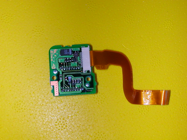

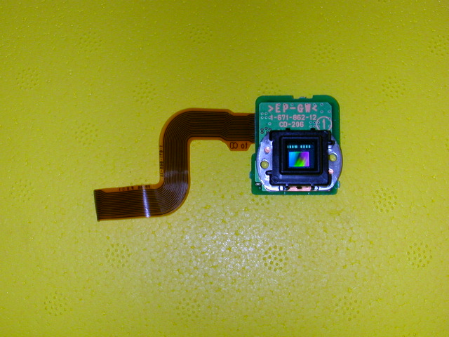

Ok so I today I remembered that I had an older Mavica Digital Camera MVC-FD81. The camera died from mechanical problems about a year ago. The board camera is a Progressive scan CCD, 850K pixels camera that I think will do nicely if and when I get it running. It took me about 5 min of disassembly to get it apart it was surprisingly easy. Now I have a board camera all by its lownsome but I’m not sure on how to find out what leads do what. I have attached two pics if someone could help me figure out what to connect where, I would really appreciate any help.

I'm guessing that you are expecting the CCD sensor to have NTSC or PAL Video Out on it. These sort of component level devices do not. They are usually addressed with a row/column/data digital interface.
Even if you found the pinout, connecting a wireless video Tx to it would require a very complicated interface.
