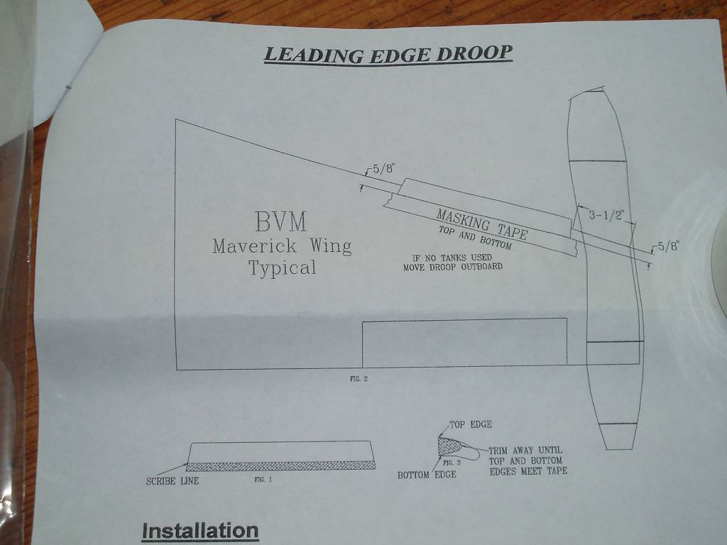

Oh, and where to find the droops? I have seen many of those in the trash can at the flying field! A waste of time in my opinion.
If you fly your new plane gently, and without excessive control travel and an aft CG, you will be just fine. Test out how slow you can get it before it stalls, up high, before attempting your first landing.
Actually, they work but you never know when, because you don't have the tip stall that would tell you should have had them.
I just did a quick search, and didn't find any for symmetrical wings.

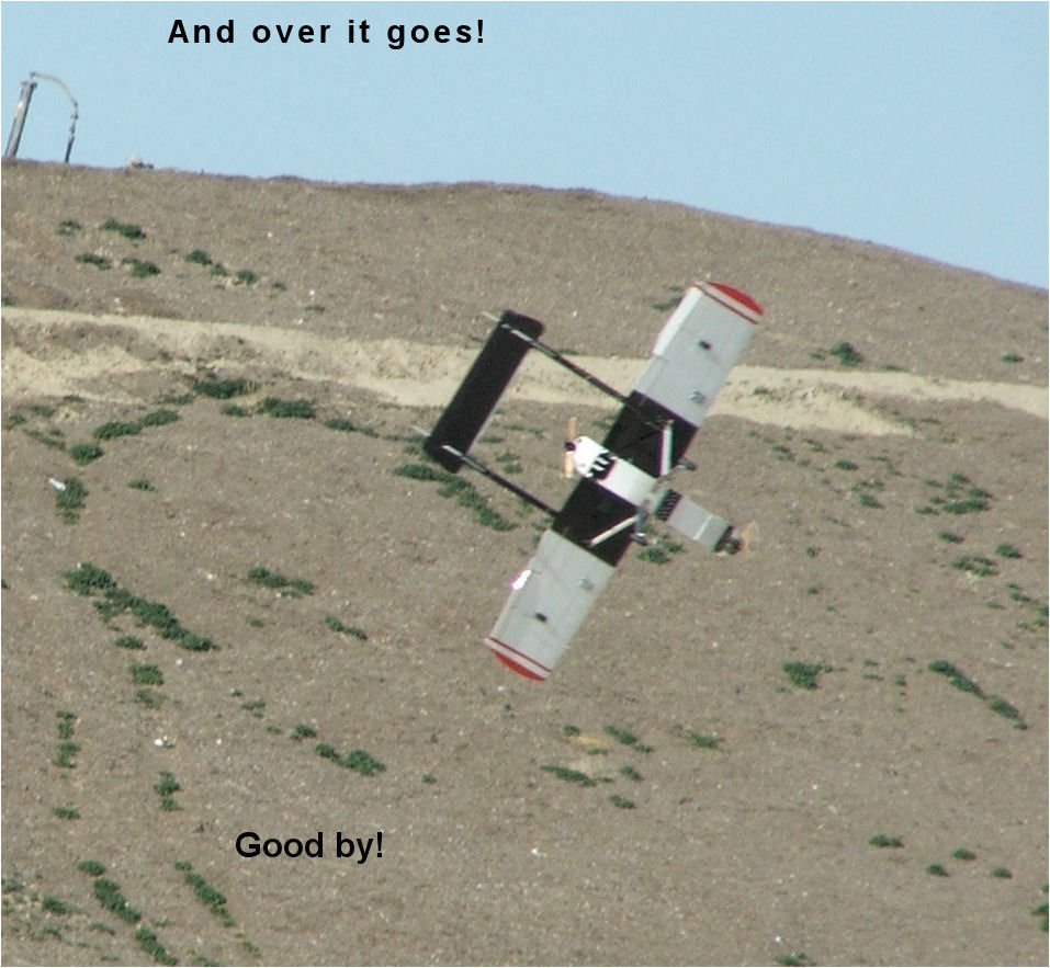

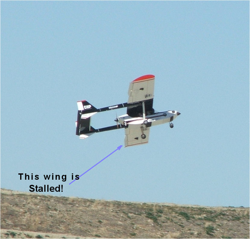

From the full-scale world..
A replica DH Comet tip-stalling just before touchdown at Fox Field... very narrow wing and aileron deflection at a high angle of attack will do this..
A push-pull Kadet tip-stalling and kept in it due to the aileron..
