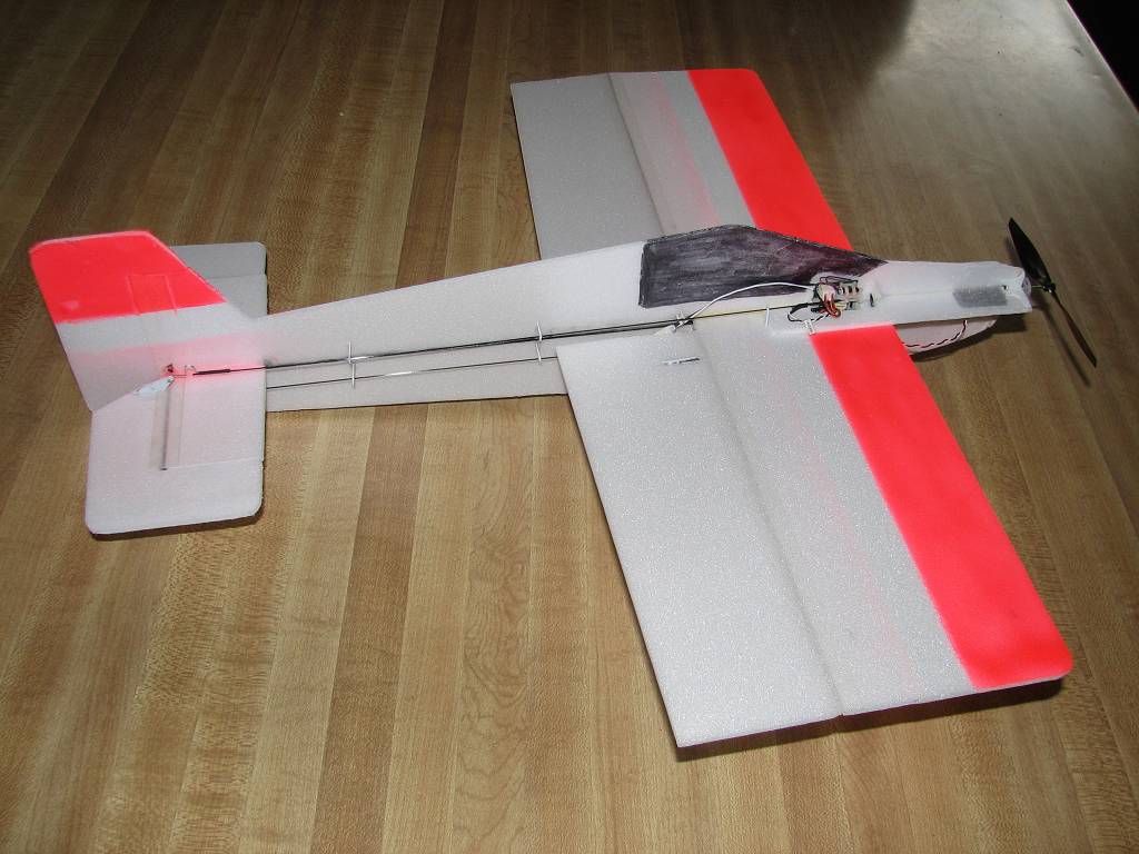

OK anyway -thefinished plane - 125 squares / 44 grams inc battery
The wing loading is OK-it takes off is airborne (about 6"high)and lands in fifteen ft!
Powerloading is a bit weak tho
I love these projects -
For peanuts -you can check out concepts .
I was once ,one of the modelers who believed airfoils were crucial to performance of our models -
The actual shape -Clark Y /24 12 symm etc- do make basic differences but switching from say a flat to a sharp le on this little stuff means absolutely nothing.
The ability to do some basic cambering -really showed up on this one- flaps work with elevators just like on a U Control
The 6400rx and servos weigh a few scant grams and are extremely accurate
Actually more fun than the larger stuff I flew for years
wing loading is about .8 oz per sq ft-
(125/1.5)
I used 28.349 as one ounce

Your talking just a bit over 1.5oz/ft wing loading, that's not bad!
I bet it does more than just takeoff.

You built a 4 channel airplane, with landing gear, and it came out at 44 grams that is great work!

my math-was terrible and done backwards in my head
so 1.5 ounces (44grams)
divided by .86 sq ft (125 sq in) =1.74

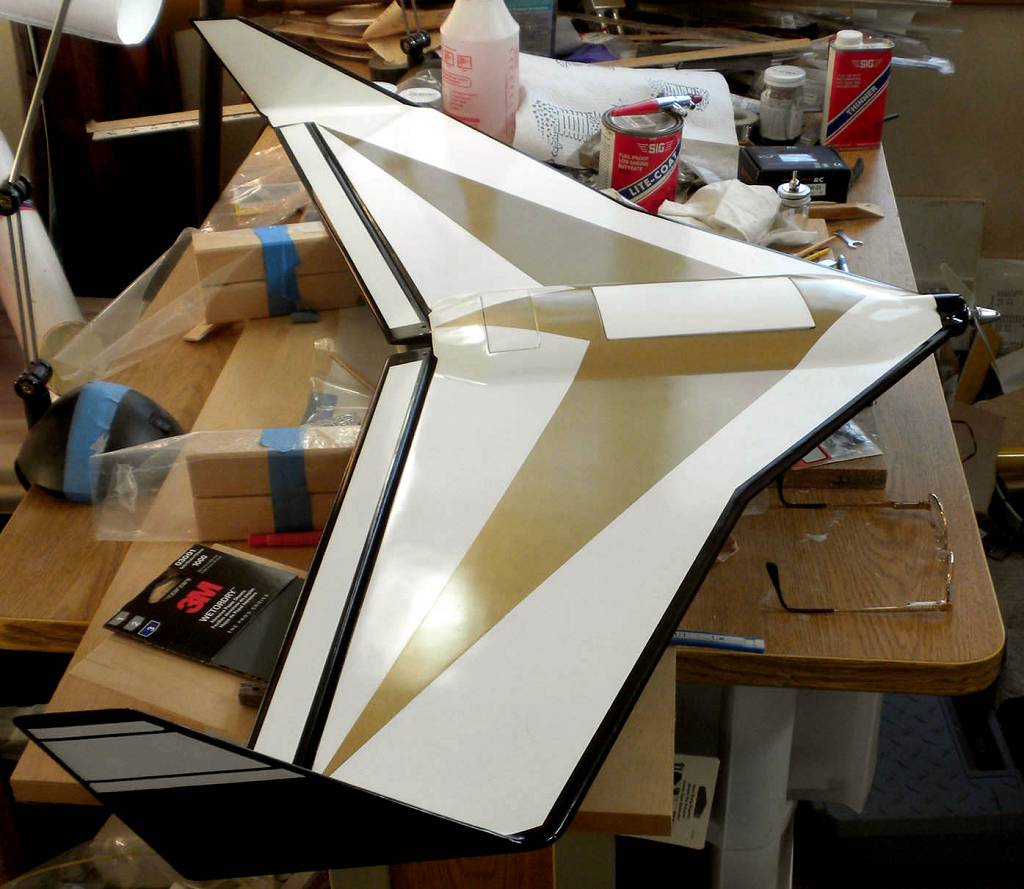

Regarding flat plate airfoils, I recall back in the late 50's or early 60's NASA or it previous incarnation experimented with a flat airfoil for use in the hypersonic region, I think it's designation was NADA or something along those lines...
The one thing I remember is that it actually worked fairly well for them, it was essentially a flat plate that had a rounded LE and tapered TE, and other than that just a flat plate between.
I can not wait to see how my "flat plate" airfoil works on this one at 2 lbs AUW on 516 Sq inch wing.

If it does not flex under loads -it should be great
I found that holding shape on the aerobatic stuf really made a difference.
some stuff was flexible and was always hunting Pretty modle also - my little foamie is a SWAG to se if power and or weight needs adjusting

Well that plane has the diagonal ribs you suggested to stop the flutter issue, how it holds up under flight loads has yet to be seen.
I have to wait for the snow to melt, and the swamp that is our flying field dries out, before she gets put into the air.
I just did the fancy paint work to hide the Clorox bottle look it had going, no real detail work just a little camouflage. (I guess I was overly sensitive to some comments about pictures of it that I posted of it before)
I use to do some scale stuff myself but have really focused on late on just the structure and performance.
I have a few foamies that really look nasty but fly pretty good, I am really don't care much about how they look anymore, yours looks a lot better than mine do.
My Easy star with carbon tow on the wings and fuselage would be a good example of nasty looking...
That's a nice looking scale model, I wish mine looked as good!
Right now for the most part I focus on the structure and keeping the weight down, that seems to be the best approach from what results I have seen thus far.
This model is not typical for the type of plane I like to fly, it is basically nothing more than an experiment to see if a 3/8 inch thick wood structure wing can withstand the rigors of the flight envelope it was originally designed for.
