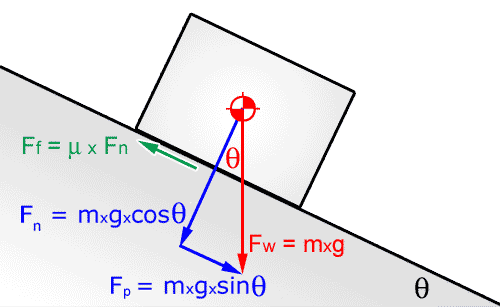

Of course, the final performance results by improving the friction coefficient of the skin depend on several factors (amount of wet surface, coefficient and condition of old skin, velocity of flight, etc.) and it should be different for each case.
You can determine the difference in friction coefficient of each skin by testing a sample.
The material should be used as the surface of an inclined plane.
The coefficient (between the materials of the skin and testing block) is always the tangent of the angle at which the block starts moving down the plane.
