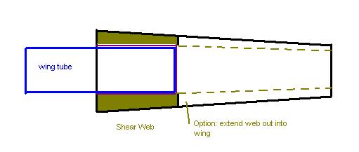

Enrico, the rib isn't the structure that takes the bending load of the tube. The spars do that. The hole in the rib can be any size, just so long as the tube itself is supported in the wing.
Posts: 1,928
From: Deland,
FL
Yes, you don't want to tube that is too small in a foam wing. THat would leave a lot of foam between the skin and the tube structure. Bigger is better. Being that the bending loads need to be transferred from the skin to the tube, this is important.
In some cases, the foam is strong enough to transfer the loads but only if the bearing strenth isn't too high. A large diameter helps reduce bearing strength.
In most cases, especially for aerobatics, the loads are transfered by a ribs at the outboard and root ends of the tube. THe hole size thru the rib is not critical. THere isn't a lot of chordi=wise bending load in a rib that would be a problem, and it will be surrounded by skin that will keep it bound in place.
What I don't understand is why I don't see more wing tubes installed with shear webs between the tube socket and the wing skin. Seems to me it would be a more efficient way to transfer the loads to the tube than the point load of an outboard rib. I had a set of wing tubes come loose on me, and I installed new ones with shear webs out to the skin. Seemed bulletproof to me.

Posts: 1,928
From: Deland,
FL
Ok, I drew up a sketch. It is looking from the front, at a cutaway view of the wing along the spar line.
The shear webs are vertical pieces of balsa between the tube and the wing skin. It would transfer bending loads gradually and along the direction they are occuring. The web could even extend out into the wing beyond the tube to try to reduce stress concentration at the end of the tube.
