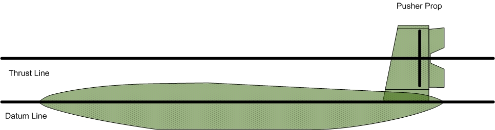

I'm am totally novice when it comes to aerodynamics so please be kind.
Hypothetically this is a 25 - 30 lb plane. The pusher engine develops maybe 19 lb of thrust. Generally speaking, what is the affect of having the thrust line well above (9"maybe)above the datum line? Assume that the wing, stab, datum and thrust line have the same incidence.
TIA,

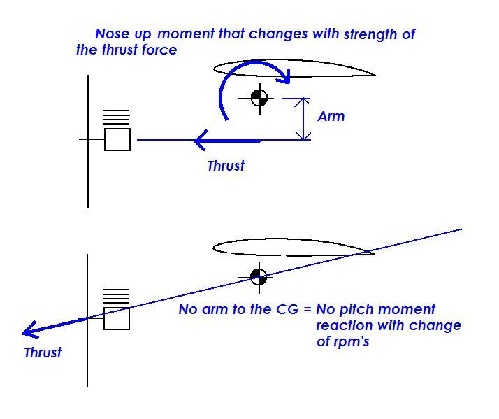

There is a nose down pitch that is induced by the moment or torque of the thrust force times the distance of the perpendicular to the CG.
For the airplane to be stable in horizontal flight, the sum of the moments and forces respect to the CG must be zero; hence, the moment that is induced by the thrust must be balanced by an equivalent pitch up moment.
Generally, that balancing moment is achieved by a combination of several gravitational (from CG locations) and aerodynamic (from airflow) forces and their respective arms.
Downthrust and upthrust angles tend to reduce the arm of the thrust.

ORIGINAL: SeamusG
I'm am totally novice when it comes to aerodynamics so please be kind. [img][/img]
Hypothetically this is a 25 - 30 lb plane. The pusher engine develops maybe 19 lb of thrust. Generally speaking, what is the affect of having the thrust line well above (9'' maybe) above the datum line? Assume that the wing, stab, datum and thrust line have the same incidence.
TIA,
It will drive you nuts- especially on launch-
the salvation is to instantly gain enough speed to get the wing and stab working -otherwise -it noses over fast.
I just junked a similar ,slower setup and went to a setup with the thrustline (pusher ) almost centered on the wing -the design is for camera work.
the problem is that the drag is all lower than the thrust . It is exactly like trying to push a carton across a rug-pushing on the top edge.
Lots of goofball flying boat designs used that same engine up high setup
lousy concept- forces are all working at bad angles.

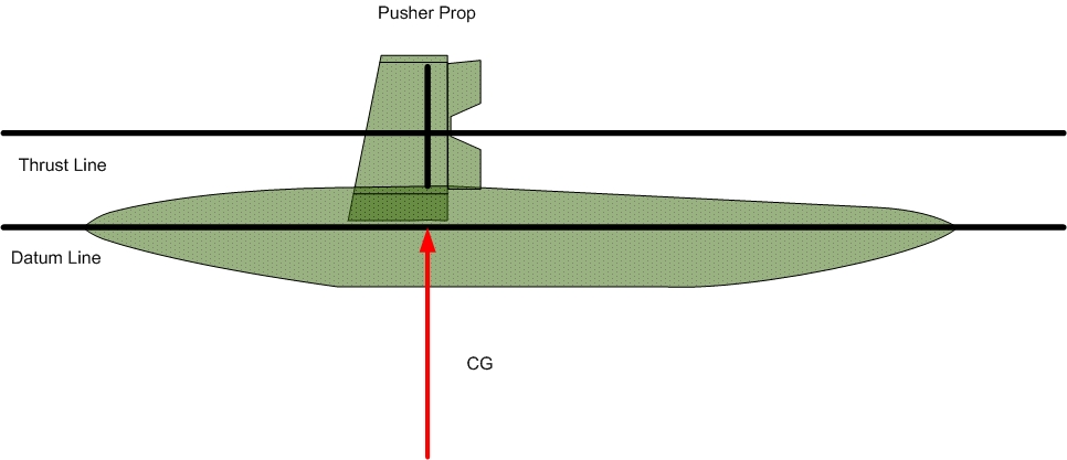

Default RE: Pusher Prop Thrust Line Offset from Datum Line
Got it. Seems that trimming this kind of package at different throttle settings would be problematic.
Em, if it's big enough - perhaps onboard computing with a ton of sensors ...
rmh - Iposted this before I saw your post ...
Are you saying that you dropped the thrustline like Ihave in my pic 1? Or pic 2?

Not an impossible layout, though.
In this design, the drag of the tail group, combined with the lack of landing gear, induces a nose up that helps.
Also, the range of the recommended location for the CG is very small.

The vertical chunk at the rear in the location typically reserved for the vertical stab is a 12" diameter ducted fan assembly with a 4 blade prop spinning at a low low 13K. The vertical stab will go down from the fuse rather than up. The center of the fuse is reserved for a vertically oriented ducted fan for VTOL capability. Just thinking out loud.

With your original diagram you'd want the thrust line to be angled somewhat down towards the nose. Likely something like 3 to 4 degrees.
Before you actually take on this rather massive sounding project I'd suggest a series of half size models powered by smaller glow or electric engines/motors to test each aspect. With a quickly built model you could fine tune the amount of "downthrust" angle to achieve reasonably neutrally trimmed throttle changes.
