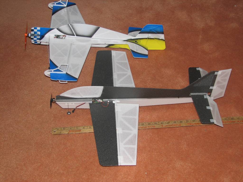

The typical really light model uses an almost OR dead flat wing -
Our newest outdoor injected molded foam model uses an airfoil that is about 5% in thickness - .
our light stuff is about 2-3% in thickness.
The benifit of thicker wings is to allow a larger margin of flyability at higher AOA- AT HIGHER LOADINGS.
So- the increase of 1.5 using flaps simply does not apply to these shapes at the lower loadings
IF the wing was an old fashioned fatty of 15%- yeh -I can see how the flap would offer a big increase.
Our "overpowered" models can be brought to a extemely high AOA under power and litterally dropped into a landing

More relative thickness of the basic wing REDUCES lift-which makes the need for flaps to obtain high lift (and drag)
Ex: Start with an shape which is simply round - If it is not rotating- it simply will not lift at any angle of attack
now flatten it some - we get some lift at any + angle of attack -and AOA is not critical
flatten it some more, etc.. the critical nature goes up as the fineness ratio goes up. OK?
Now when we get to a very flat airfoil - we can generate huge lift at very low deflection (aoa). the drag also goes up .
The craft will slow very well and until critical angle occurs - It acts like a flapped, thicker foil. The thicker airfoils don't interfere, they just don't contribute as much lift at low AOA as a very thin one
