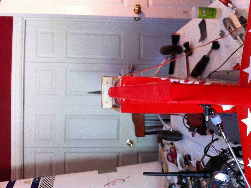

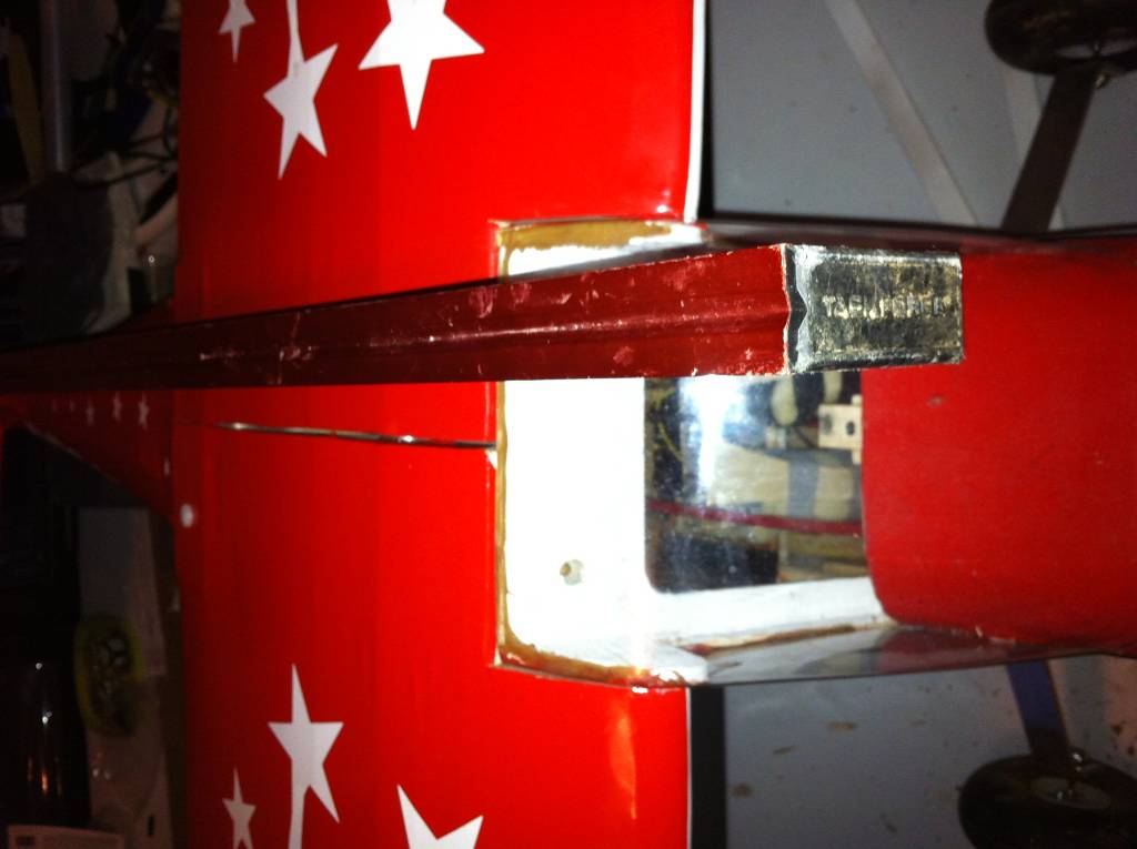

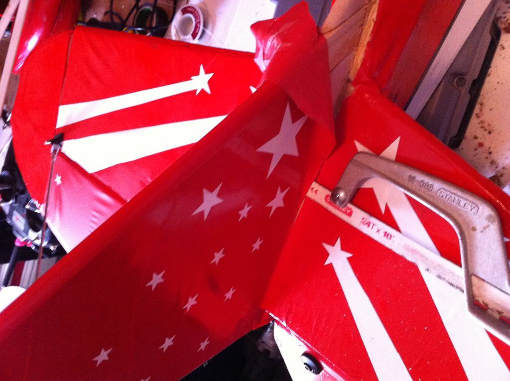

hello,
thank you so much.
i believe the wing may not have been the problem at all.
let me tell you what i did today. i could not sleep all last night, thinking that possibly there was an error on my behalf when i built the airplane and placement of the fin. I also thought, why does plane keep rolling to left when i flew it, however, aileron trim did not help and rudder trim to right did not help either.
so this morning, i tool a lightweight 4 foot long builders ruler and balance (in one), and placed the ruler parallel to fin on left side of it, and near to wing bay, forward to wing, i noticed that it was ligning up on a point to the left of the midline of forward fuselage by about 25 mm.
that means that the fin leading edge is heading towards left side of airplane, and when thrust, which is aimed to right by 3 degrees, this air pressure (thrust/wind from motor) is greater on right side of fin instead of equally distributed on both right and left side. this turbulent air flow on the fin, which has a higher pressure on right side of "twisted" fin, and causes the plane to roll to left.
at least, this is my theory.
i carefully cut the coverite on the right and left side of fin base, and using a flexible thin saw blade, i detached the leading aspect of fin from fuselage all the way to rear except for the trailing 1 inch of it.
i then used a laser light, and attached to a flat ply wood, placed it on side of fin so that laser light was in front of fin, then slowly moved fin to the right until light was in center of fuselage and in line with propeller blade, which i placed upright and i also used the level which hung from prop hub.
i reglued it.
let's see what happens.<br type="_moz" />

If the vertical stabs LE was left of center with regards to it's TE thenthis would cause yaw or rolling to the right, not to the left. <span style="color: #800000">Centering the verticle stab(fin), will now cause an increase in the left rollproblem if I am reading your post right. Check your right thrust again.

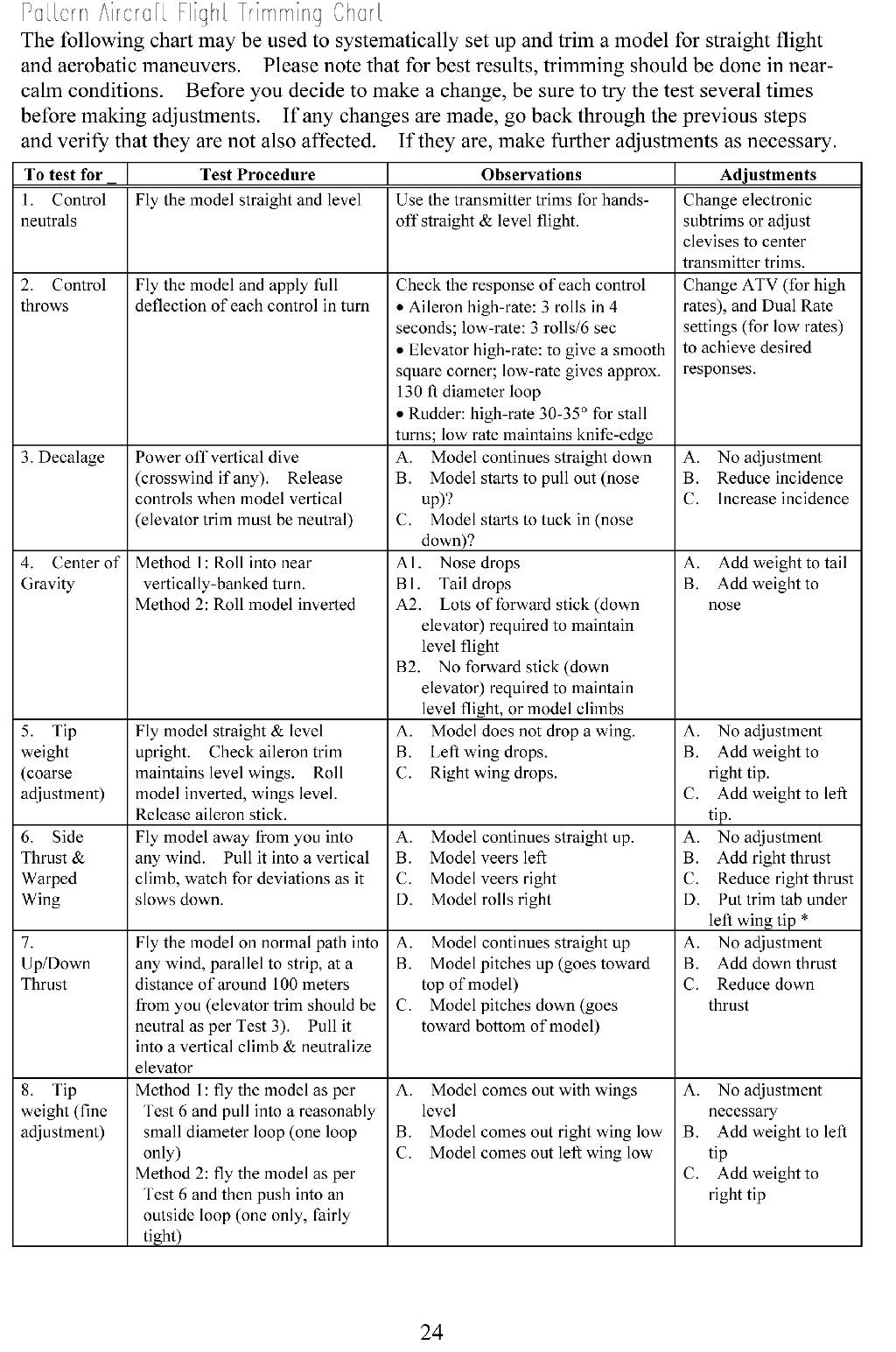

Attached pic is a quote from a series ofarticles Dean Pappas wrote for Model Aviation magazine called Timming for the Gound Up.The three articles numbered 29,30, and 31 are about trimmingHere's the linku will have to use your AMA # to log in.
http://www.modelaircraft.org/mag/ftg...29/29main.htmlgoto the FTGUIndex http://www.modelaircraft.org/mag/ftg...espageftgu.htm to find the other two trim artcles

The firewall had built in 3 degrees right thrust and 1 degree down thrust<br type="_moz" />
This makes sense
Tell me wha you think of this
The engine is an saito fg 36
That came with its own engine mount
The engine is not upright or inverted
Instead the cylinder head is out to right
When I built the plane

hello. this was this birds 3rd flight, and by far, the best yet. but to me, still not good.
1st flight: plane took off no problem, i immediately noticed it wanted to keep climbing, at the time, i was unaware, but the bird was flying way tail heavy. the way i checked CG , by suspending plane from wing tips at CG point, was way misleading. I then trimmed elevators, to help with flight, but this was not much. when i could get plane to fly level, by holding elevator stick up, then once plane in semi level flight, it would immediately roll to left. soon after that, very quickly, i said, this is not fun, this is not the way to fly. believe it or not, i was able to land the plane, only damage was the landing gear bent on one side. this was fixed easily.
2nd flight: i addressed CG issue, i added about 16 ounces of weight to nose, and i shifted all servos and batteries as far forward as i could. this time, plane took off, did not appear to be tail heavy, this was improved flight pattern from before, however, plane kept wanting to roll left. i also had made a change to the plane prior to second flight, whereby, i made trailing side of right wing sit 5 mm higher on right side of wing bay saddle area, using incidence meter, now both wing roots were even. i still was not satisfied with this flight pattern.
3rd flight: i redid the fin, so that LE was not to left of TE. i believe the fin is well centered this time. this flight was best of all, however, plane did want to roll left. trim did not help much. prior to this flight, i did a CG check, and plane was neutral, i also checked side to side balance. i placed a string under a low hinge on rudder, and tied another string on prop hub, my wife and i then elevated plane off table in a room with no wind or breeze. i was thinking that possibly left wing would be heavier, but to my surprise, it was the right wing which was heavier??? i then added 1.5 ounces of weight to left wing tip. this leveled it out side to side. the flight, again, plane kept wanted to roll left. i am still not satisfied with this bird. i am now going to put all batteries under gas tank, and remove added weight, hoping to balance it this way. i may be able to get rid of 12 ounces of extra weight. that will make plane 18 .5 pounds, better than almost 20 pounds it was at first.
i need to make a correction. the Dynaflite super decathlon build is for 2 degrees right engine thrust and 5 degrees downthrust.
the incidence is -3.5 from stab and -2 from wing.
i believe my plane has +3 degrees incidence wing relative to stab.
the thrust is: +3 degrees to right., downthrust is +2.5 degrees
thank you for the advice and guidance.
do you think i should add more thrust to right and down?

Downthrust is off by a huge amount.
I checked the Dynaflight technical specs and it recommennds 5 degrees downthrust that would be -5 degrees. If your plane has +2.5 your 7.5 degrees off. I'd leave the 3 degrees right alone for now.
For the incidence if your plane has +3 relative to the stab that's +1 degree wingincidence which makes the wing incidence 3 degress off. according to the tech data it should be -2.
Until these anomaliesare verified and fixed to there static values you're not going to be able to get and handleon the left roll/yaw problem. These two out of spec adjustments maybe making the planeunstable enough to cause the problem in the first place. Fixing these two issues may be the solution.
My Kaos wing happens to be heavy on the right wing by .75oz. Problem is when I add the required weight to the left wing to balance it laterally, the left wing stalls horribly when entering a loop and then does corkscrew loops. I removed the weights and it tracks fairly straight though the loop with the right wing heavy. Go figure. I'd remove the weights on yours as well at least until u fighure it out left yaw/roll problem..
