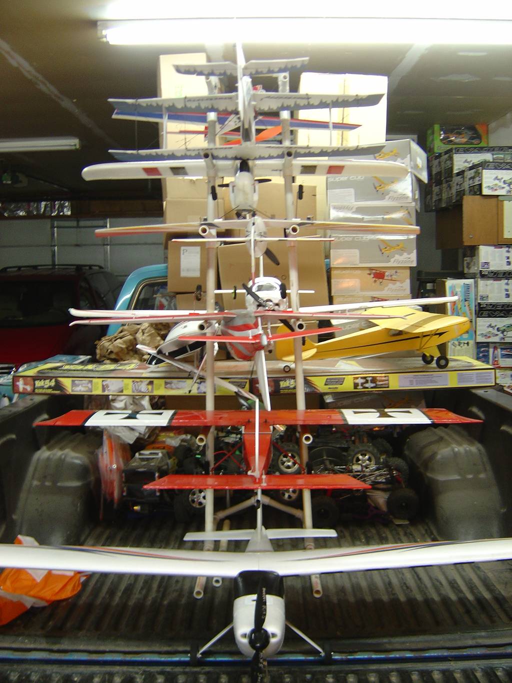

I have many planes that are just flat at the ends , maybe the underneath is taper up. I also have some that have the ends of the wings hung or bent down. Then I have some that the tips or ends are turned upward.
The reason I asked is because my new millenium is supposed to be flat yet it came damaged with both tips bent UP. I'm wondering what adverse affect this may have on it.

All depends on what the designer thought looked good. Wing tips on our models do very little. Different story on full scale as tip shape can be used for stall control and effeciency increases, not so much for our models. I'm sure all the full scale theorists will come in and argue my point of veiw. If anyone is willing to test some different tips on a telemetry equipped airplane and report the results, it would be interesting.

Tip shape DOES make a difference, sometimes quite markedly. A tip that is tipped up tends to act like increased dihedral and does give some righting ability just as dihedral does. On high performance models like some gliders, tip shape and form can make a great difference.
Wing tips can make a difference you can notice, especially if you like to experiment or make a plane fly better.
