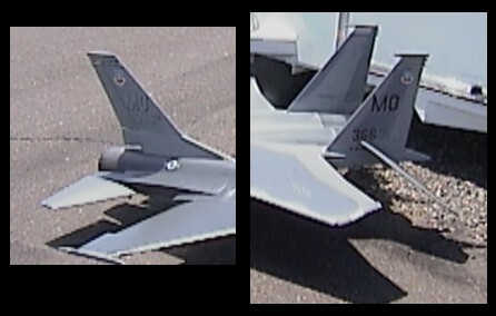

Here are some images that might help.

Mike... I'm not sure what to make of the photos you posted, Can't quite see where the horiz stab is pivoting.

Better Picture!
The pivot point looks to be at about the 50 or even 55% root chord, but with the swept tail plane, it "looks" like it may be at the 1/4 MAC... I don't suppose you can pull any numbers out of your hat Mike! (root chord, tip chord, sweep angle)

No, I just copied the image from the BVM site, and there weren't any 3-views or whatever there.

Ken is correct. I couldn't bring up the tail link he mentioned but the photo of the BVM kit seems to put it at around the 25% mac of the tail.
