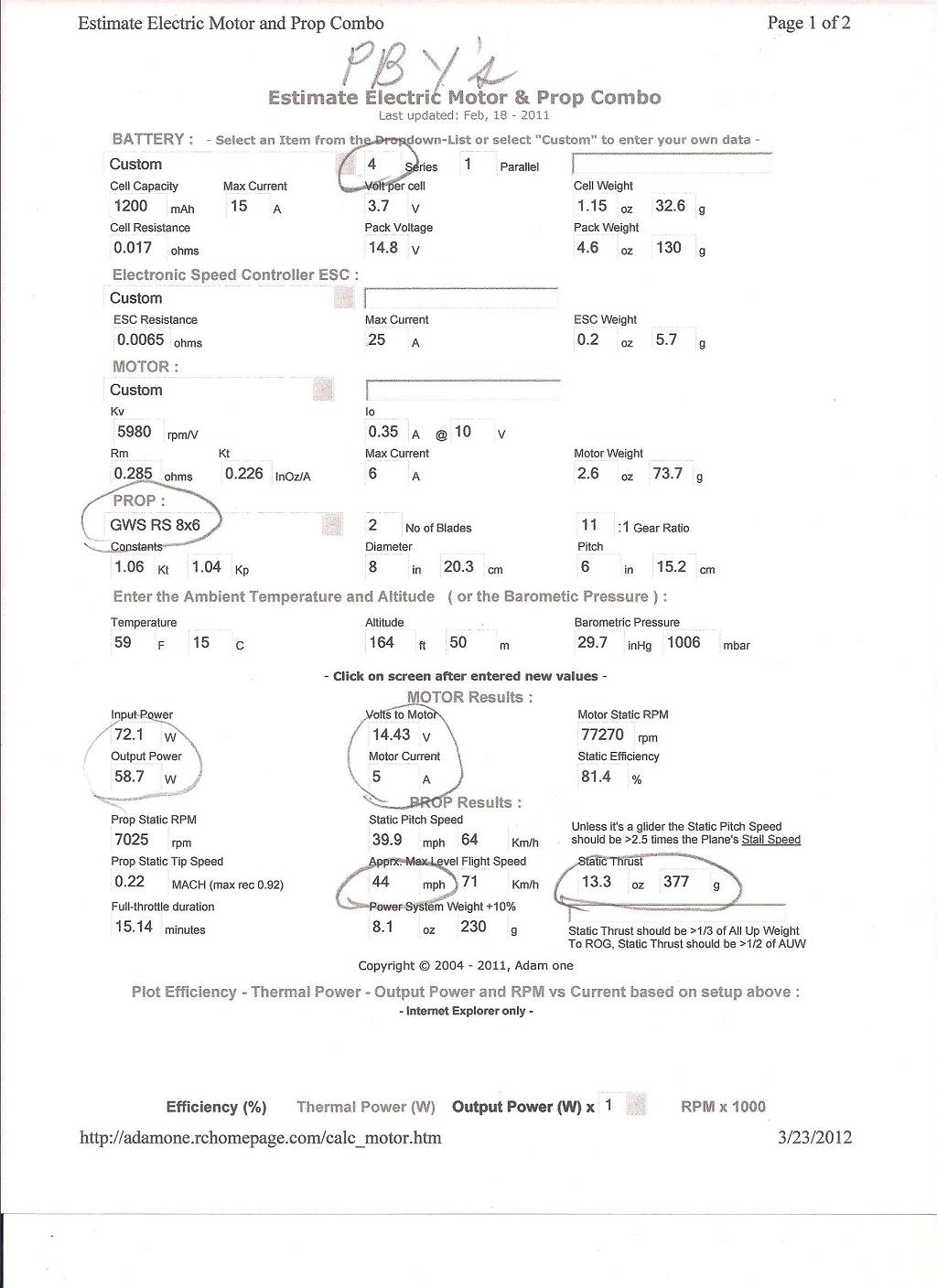

HS-81s don't draw very high, but the HS-65s are pigs, and I typically get 3 or 4 flights from a 350mah pack with HS-81s.
EG
The aDVICE FROM cOMBATPIGG IN POST #4 IS CORRECT.
A good plane flys first on paper & a motor & prop/battery calculator. There are plenty of good power calculators on the web.
I find I can spend a couple of hours on a power & flight calculator & be VERY satisfied with the completed planes.
One of the local clubs tried a 350 Sq In version. If memory serves me they had a 40" span and were powered with .25 engines.
