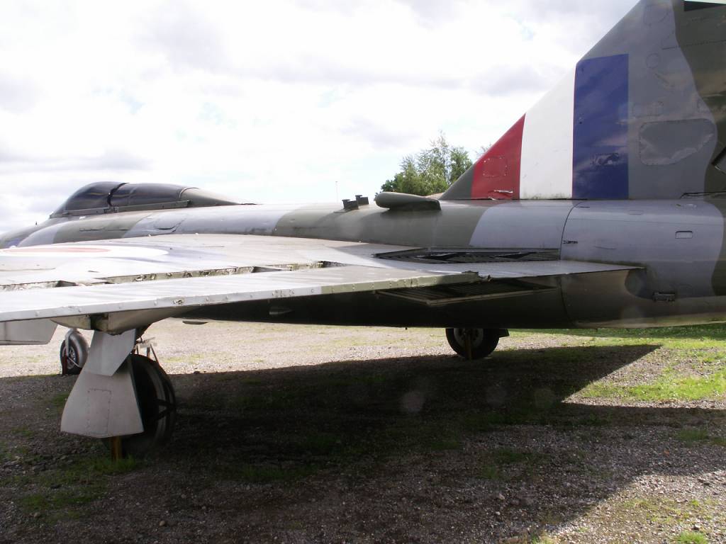

Do you have a name or two of full scale planes with thick, square TEs on any surface? I've never seen any ever and would really like to see what thickness is being used.

ORIGINAL: da Rock
