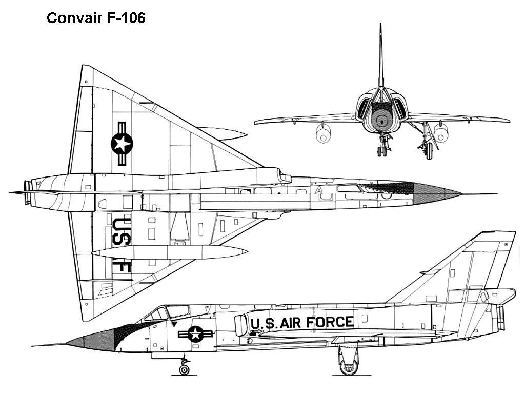

Ok here it is.
I am building an old ZIA Models/Flight line F-106 delta dart. The wing has a 42" span made out of solid 1/4 sheet wood. No airfoil. The kit has 1/2 wide plywood strips that glue on the tip and a 1/4" tall strip that glues on top of the wing to make a chine/strake. I would like to put the wing strip on the bottom to look better but not sure if it was designed to help with producing lift if installed on the top of the wing or to just stiffen the wing. I know with this flat wing there is a very small AoA angle that will produce lift before it turns into a kite per say.
So build it as designed or will it matter if the 1/4" tall strip is on the bottom of the wing? For the wing tip what will help the most with lift? having a 1/4" above the wing tip or 1/4" below the wing? Should I go with a larger wing tip?

If the strip is glued to the top of the wing then it's not really a chine or strake. But if it's about half the span out from the fuselage it may be a flow straightener fence similar to that found on the Mig 15 as one example. If this isn't the case then a picture of that portion of the plans would aid us in figuring out what it is you've got.

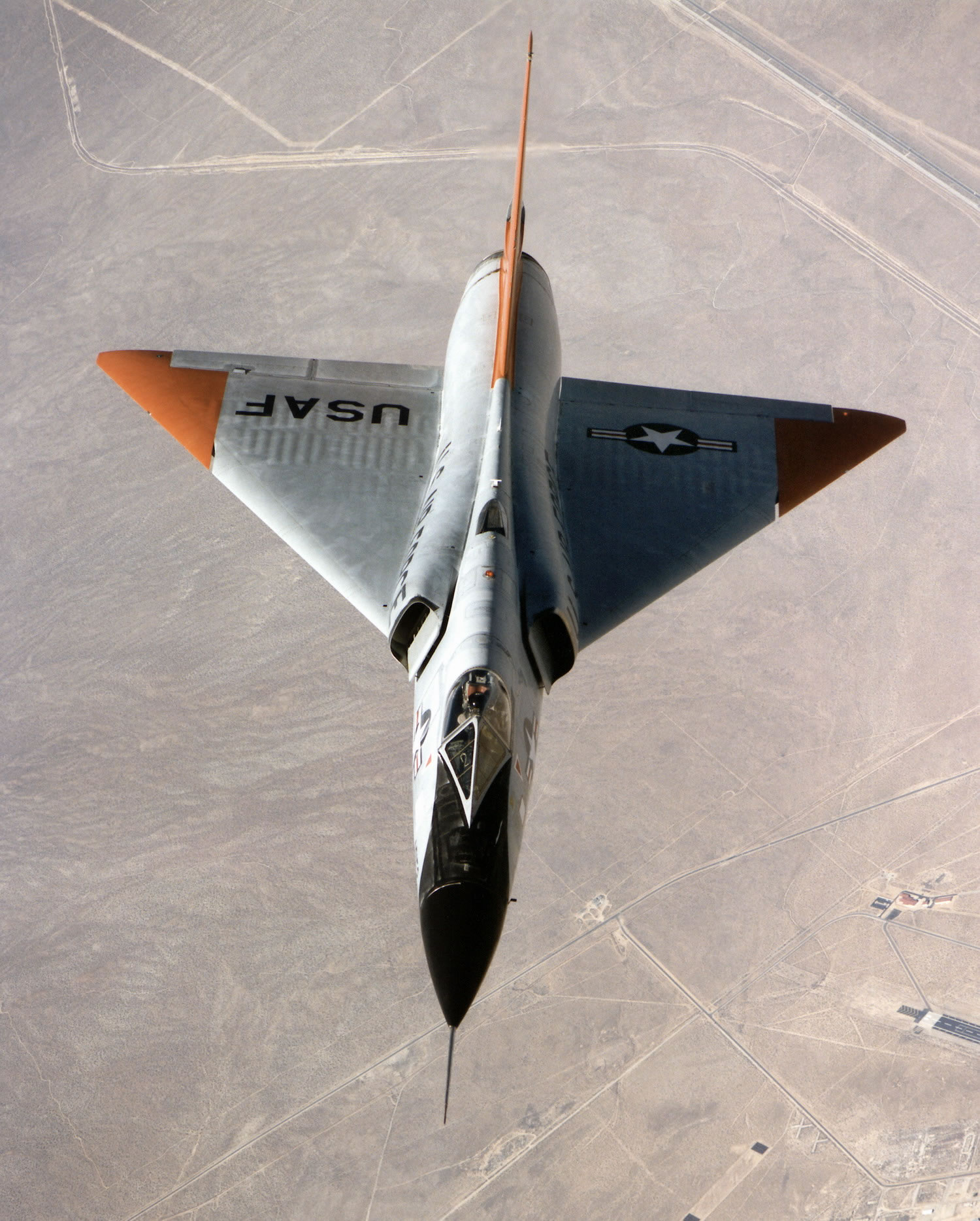

Interestingly the original didn't seem to have such strips, at least on the top surface. There are equipment rails under the wings and strips outboard those rails as well.

the plans show it at the mid span on each wing. I am not asking what the name of this piece is just is it better to have on the top or the bottom. The plans show it on top of the wing. remember this plan has no air foil. I would like to have it on the bottom of the wing if it isnt needed for aerodynamics on the top.
My dad and I flew this in the late 80's and flew fine as long as the engine was running at half power or better. less than that and they turned into a guided rock.
