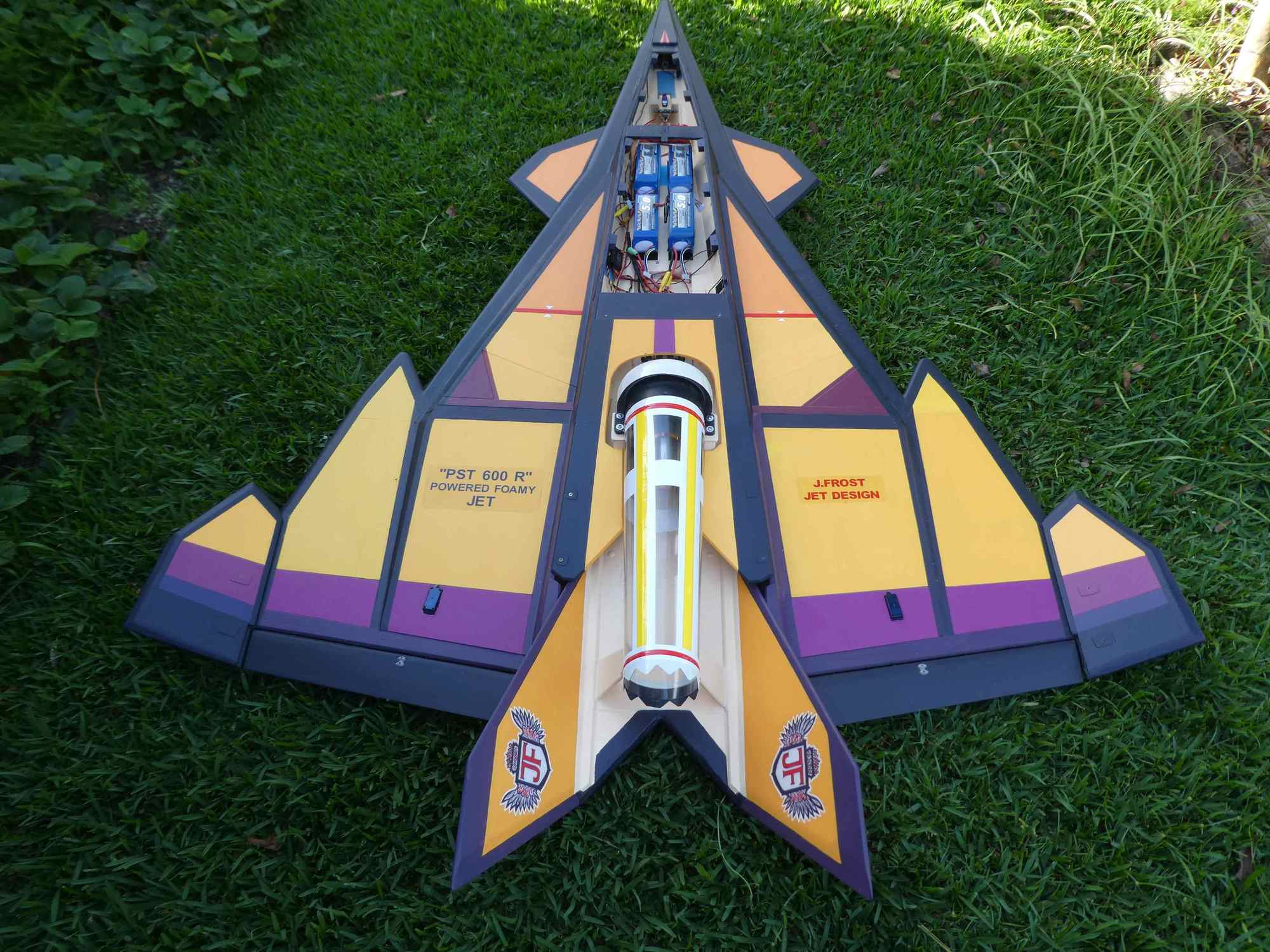

With scratch build models I normally build a smaller 30-50% scale size prototype as a hand chukker or sling shooter to make sure my guess CG is spot on.
CG proto, R.

It all depends how much you value your model, when I put few hundred + hours into the project I want to make sure I won't screw up on the first go.
I had a few very stressful moments in the past with no idea about the CoG, but only guessing always being so tail heavy that the only way to keep them afloat was vertical hover, bring it down as low as possible and let go! LOL.
