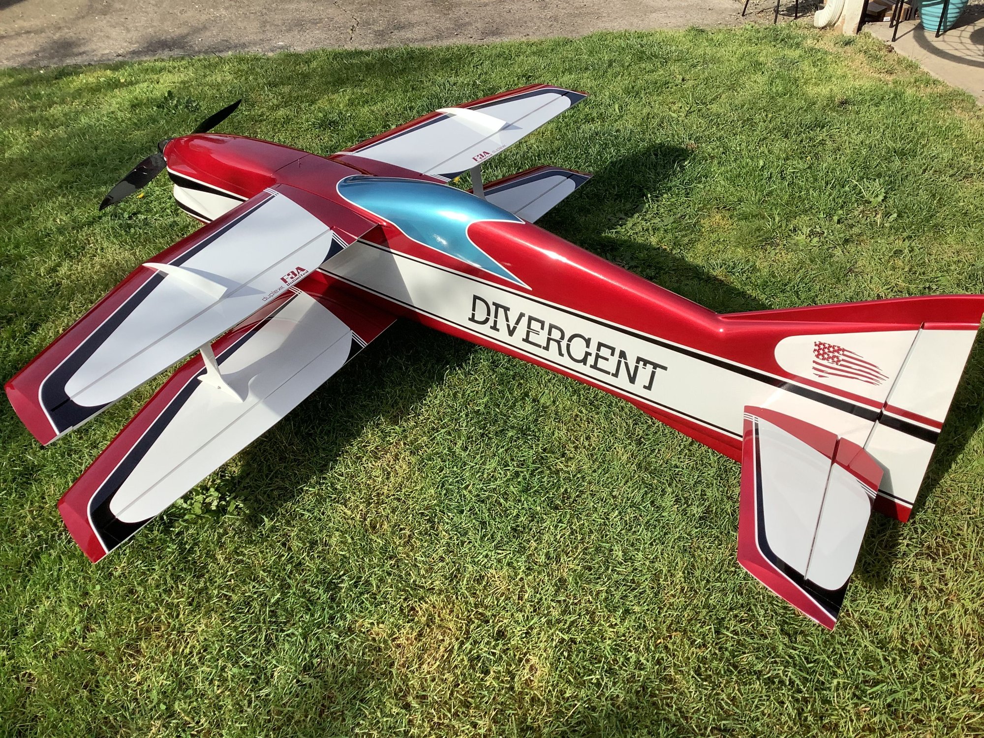

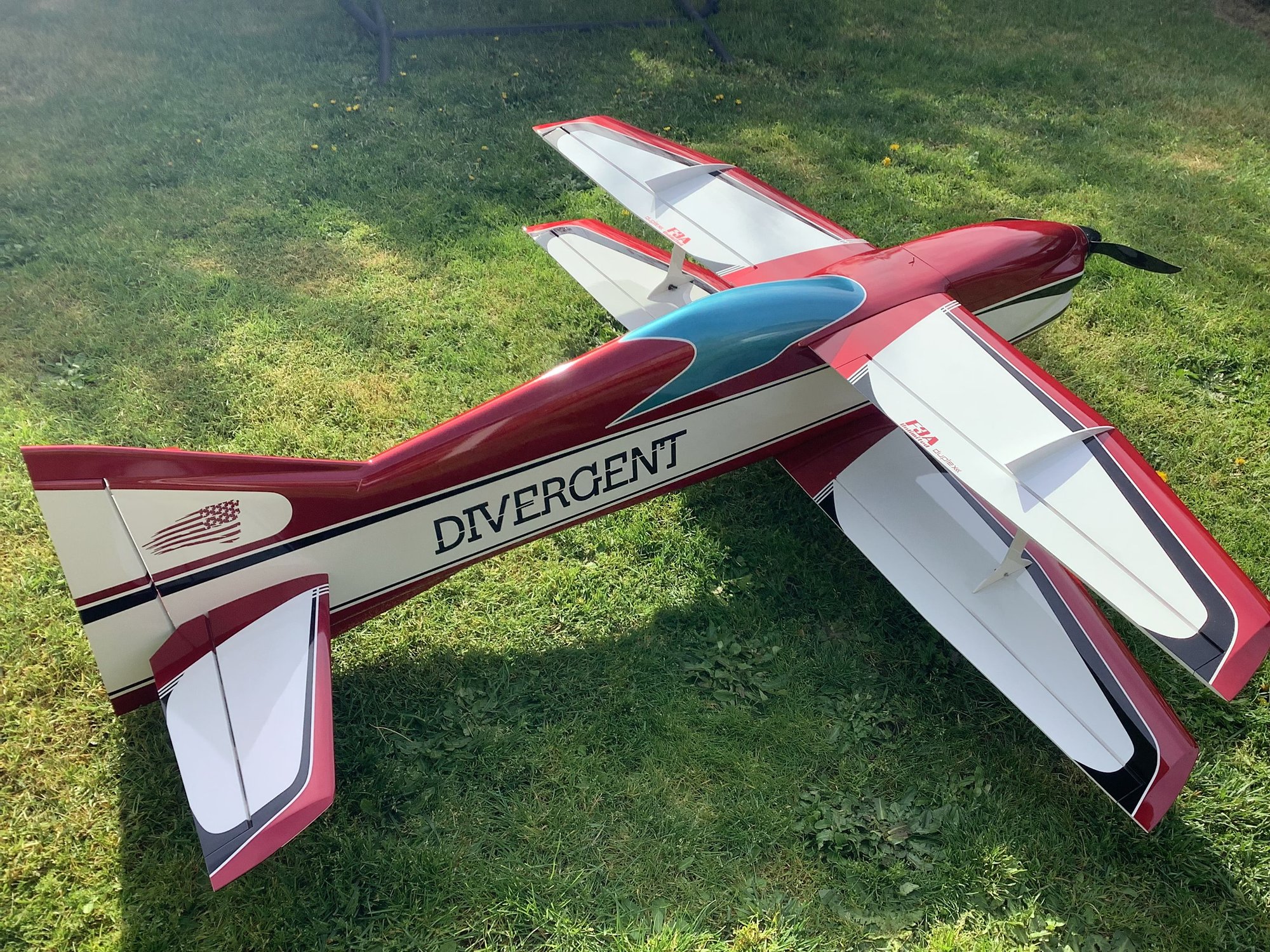

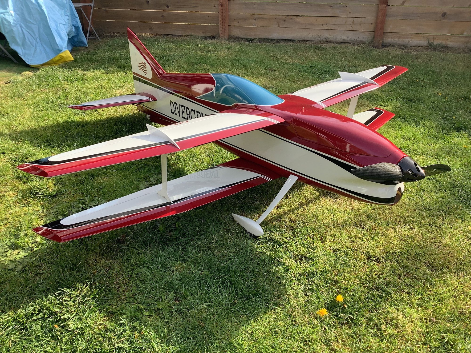

Here is a good example of what I was talking about. My latest build of my F3A design Divergent. The motor has zero up or down thrust but has 3.5 degrees of right thrust. The upper wing and stab are at zero degrees in reference to motor. The bottom wing has 1 degree positive incidence. The four ailerons have exactly the same travel. I measure them at high rate which is 25mm up and 23mm down. That small amount of aileron differential fives me very nice axial rolls.
