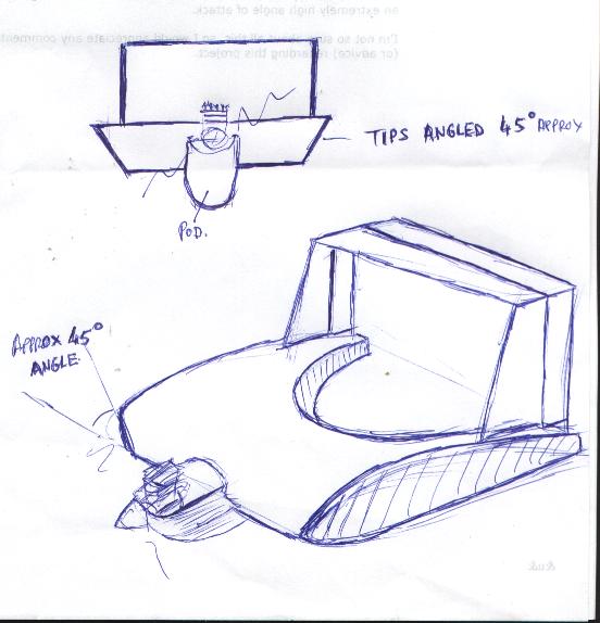

A workmate of mine has decided to build an aircraft with the following description:-
28" wingspan
36" chord
6" camber.
The airfoil is flat bottomed.
Weight is expected to be 2.2 lbs.
It has a semicircular cutout at the trailing edge effectively making it twin boom, with 2 vertical fins and a high tailplane and elevator on top, the main lifting surface at the tips is angled about 45 degrees downward and inward.
Construction will be completely of polystyrene ( except for engine bearers etc )
It will be powered by an OS LA 25. Covering will most likely be coloured parcel tape or similar.
He intends to use rudder/elevator only, and expects that it will be able to fly slowly, and be able to hover at low throttle settings with an extremely high angle of attack.
I'm not so sure about all this, so I would appreciate any comments (or advice) regarding this project.

I'm not sure I follow your description either, but it sounds somewhat like a vaiant on a PBF-type plane with a high-mounted horizontal stab and elevator. My first thought is that you'll want some roll control, rudder only won't do it, as I don't think you'll have enough dihedral effect. I'm not sure though, since I'm not sure I follow the description.

tell him that it will be uncontrollable with rudder control and no dihedral.
a picture or drawing or even a scribble on a fag packet would help us muchly!

Hi everybody,
Please understand that I'm only the messenger but I'll do my best to explain!.
The guy who is building it believes only in the simple ways of doing things, and leaves out anything which he considers unnecessary, hence his 3 channel radio, and his dislike of computers! ( also computer radios ). However, he does seem to be very good with hunches and has built quite a few weird contraptions which flew successfully.
I think that you are probably on to it JOHNG, I'll look up the machine you mentioned.
Actually it doesn't look completely unlike TALL PAUL'S light hearted depiction, but it won't have wheels ( he considers them totally unnecessary) nor the broken looking tailplane.
He will hand launch it, and land it on a polystyrene pod under the engine bay, which will be ahead of the leading edge, the pod being there to make hand launching easier, and to prevent the prop hitting the ground on landing if the engine is still running. ( This is standard practice for him - He thinks that all the hassle of takeoff is unnecessary.)
He also believes that it will be possible to land it vertically, (tail first of course, and controlled! ).
I will post a sketch of this aircraft, (as I envision it to be ) as soon as I find out how to send it.

Well hope it works, ( the picture that is ), I do believe the plane will work. despite it's looks.
UPDATE NOTE:- There is a more accurate drawing on page 2 ( post 39)
Also a report on its flying characteristics further on.
That's not that far off what Tall Paul did after all.
First off I think the tips being angled like that will function much like dihedral. But for the airplane to have any roll control it MUST be moving forward so that the yaw can act on the angled tips and roll the model In a hover it won't work that way. In fact the rudders being on the upside of the model will tend to roll the model in an adverse manner instead of pro. But in truth they won't even do that because as Paul said you MUST have the controls in the prop blast during any super slow harrier type flight and especially for hovering.
As for the airfoil there's so much cut away that it won't operate as an airfoil at all. It may fly just based on light weight and body area but it won't be pretty if the engine quites. And the flat bottomed airfoil rements are going to have all sorts of pitch to speed coupling problems. He would be way better if he used a symetrical shape.
Bottom line? I truly think he's not thinking the factors out very well. It may fly but not in the manner intended as you described it.

Remember that my sketch is not a scale drawing, done purely from memory in just a few minutes, so please don't take it too literally.
Possibly you are right that the rudders will work in an adverse manner, if they do he will accept that, but not before trying it. The same goes for airfoil shape, but this is his starting point. Remember it's made of polystyrene and will cost virtually nothing!
In fact he will accept any shortcomings it may have, and if he fails to rectify them after a few attempts he will scrap it, and move on to something else.
Believe me, he is very much a thinker.
I'll pass on all the comments so far, but I won't see him again until Tuesday.
Turns out that he was going to use a 9x4 prop.

Hi, just like Tall Paul mentioned, it needs the control surfaces directly behind the prop-blast for any kind of hovering performance unless you consider a strong headwind. Basically its a variation of the flying STOP SIGN with an airfoil. That will help creat more lift and hence the slow flight at normal AOA. I do agree that to have better control at slow speeds ailerons should be used. Rudder alone can help so much on tip stalls. If the airfoil is thick enough that will also help fly it because high reynolds number. Consider lowering the "sorta T-tail" configuration to avoid high center of gravity and the possibility for tip stall sooner.
Posts: 6,136
From: CamborneCornwall, UNITED KINGDOM
forget the cutout, go with elevons. use the handle at the back for carrying and grabing from the air.
the cut out the way it is now is gonna cause a LOT of drag with it's flat rear face.

Remember, three channel radio,and no mixer! and yes, he's tried a mechanical mixer before, in case you ask.
You've said more or less what I said, (except for that brilliant handle idea of course, that's ground breaking stuff), - but this guy won't be told, so live with it.

We'll let you know what happens ( warts and all ), even about the little snowy beads!
