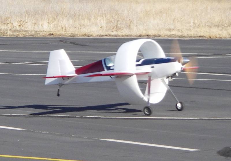

OK here is a setup - remember you drop the wing loading to zip -then add 2-1 power capabilities -the result is a model which will fly at about any attitude.
the SPEED is so low and the angles of flight are so high that flight is basically thrust with guidance by the ailerons etc..
I'm sorry, I know this post has been out there a while but I just have to say something here.
If the wing loading is zip, then the weight is zip. Then how do you calculate a 2:1 power to weight ratio? An engine capable of ANY thrust would result in an INFINITE power to weight ratio, which is meaningless. The reference to a 2:1 power to weight ratio on a weighless aircraft is nonsense.

Have to agree - the zero wing loading concept is impossible and totally trivial. It cannot be imagined because it doesn't make sense. The assumptions contradict one another.

Oh here is a project that a friend is working on - I did some of the structural work -and have flown it -- probably not worth mentioning in this column -anyway --

The tube is interesting. What is it's intended purpose?

It increases lateral area -just another way of doing this
effectively the model -in hesitation rolls or very slow rolling agenda--will have more usable lift--in this area.

Does the tube fly as expected? Does it have the handling qualities you were shooting for? It looks interesting, I am curious about it's intentional snap roll characteristics.
