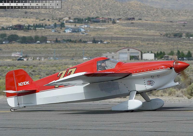

George - I have always admired the design philosophies of aircraft executions of Steve Wittman.
These seemed a bit "off track" for some --but went like hell .
Reduced to one line it looked like " If it isn't really necessary - don't use it.
After trying basically most of the current aerobatic designs - for IMAC
I am pretty sure the Cassut design really has a good chance of being very good for the new "presentation" criteria.
The "why" goes like this
it can be built strong - and very light -the layout is well suited for this
The low aspect ratio wing should allow a huge speed envelope -even better than any of the bipes.
roll rates even at walking speeds should be rapid.
The fuselage lateral area is almost equal to the wing area and well placed.
The fuselage frontal area is low.
The relative wing span to fuselage overall length needs no fudging - wing is 15' fuselage is 16 '.
As for power to weight - I have that one covered .
Do you see any downside on this setup?
other than the unusual appearance?

George - thanks for the reply - I have been flying my Spitballs -basically same layout and the inside and outside snap character is superb
instant and predictable.
So -just as a quick peek -i am slicing up a scale profile of the Cassut as yet anoher look
The aspect ratio is about the same as my Spitball.
My first real model will be 44% - for ZDZ80 single on tuned system
weight based on oher stuff done in same manner-well under 20 lbs - more like -18-19 lbs. wing area 1900+
this one really has my interest piqued!.
