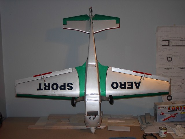

I am using active boost tabs on My HOB Extra 300L. They seem to work very well, the Plane is extremely responsive, Basically like power steering.

Old 05-19-2002 | 06:27 PM
Forgues Research's Avatar
My Feedback: (7)
Posts: 3,453
From: Glen Robertson, ON, CANADA
Default Boost tabs
Nice installation. Now that I see yours, I wish I would have made mine another color also.
For the boost tab clevises and such, I use 1/2a material to keep it light and the push rods, I use 0.080 " aluminum welding rods. They are very light. You want to keep things light in that area.

I haven't done a lot of experimenting with my settings yet, I'm still getting used to the sensitivity, Once I'm more comfortable I will try fooling around with different settings

If I may, I did notice that you might have too much throw in the boost tabs. Just my opinion. Normally, it is suggested to have only 30% throw on the boost tabs versus the actual control throw.
Too much throw, might make it hard to trim since its boosting too much and it wants to keep searching for center.
Old 05-19-2002 | 07:40 PM
Joined: May 2002
Posts: 27
From: PonokaAlberta, CANADA
Default Boost Tabs for servo help
Thanks for the input, maybe I'll tone it down a bit, It is pretty touchy

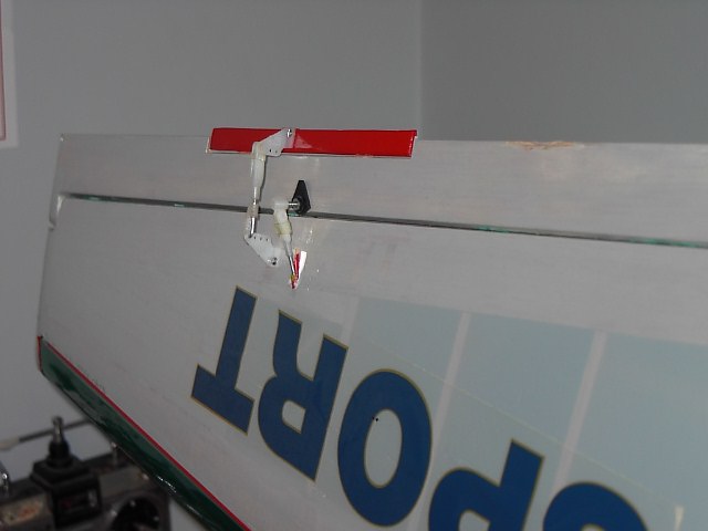

On which controls do you use Boost Tabs, and I would like to see pictures if you can.
Old 05-26-2002 | 12:51 PM
Joined: May 2002
Posts: 27
I have tabs on each aileron and on the Rudder. I built the rudder oversize so I was a bit worried I might have overdone it, so I built a tab on it. The Elevators would have required two tabs due to the split design, and I didn't want too much weight in the tailso I didn't put them on. I don't know if you can see in the attached photo, the linkage for the rudder

Old 05-26-2002 | 03:34 PM
My Feedback: (7)
Posts: 3,453
Default tabs
I can see a bit, looks like a nice installation.
