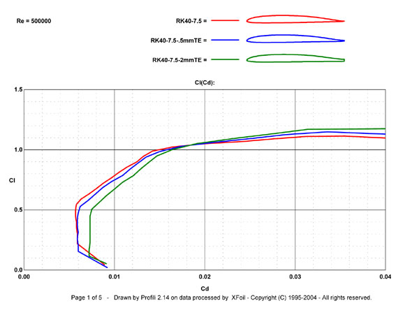

In the real world of building wings we always have to truncate the trailing edge of flying surfaces to some amount relative to the typical airfoil theoretical end point coordinate (x=100, y=0). Yet we use the polar data which assumes this perfect profile. It seems that in 'airfoil intensive' pursuits like racing, sailplanes, high performance etc, every effort is made to minimize truncation & extend the profile as much as possible & of course keep it rigid. The thinner the airfoil profile, the harder this is to achieve assuming a minimum acceptable TE thickness.
My question is, where on the airfoil polars would this truncation show up as a degradation? An overall inneficiency loss spread out over the Cl/Cd curve? Or more weighted at high AOA & therefore reduced Cl max? See what Im getting at? Do fat airfoils suffer less than thin airfoils? Is there a magic rule of thumb like "if you achieve less than 95% of the theoretical chord, the polars cannot be trusted & you need to use a fudge factor"? Assuming a truncation is inevitable, would it be better to radius the edge or leave it square?
Is there a method of determining the real-life performance of any model, and comparing that to a predicted value with any degree of certainty?

Why do you say truncation is inevitable? If performance is really important, you could choose to use harder wood for your trailing edge, and just make it sharp.
If the trailing edge is blunt, the flow will separate. If there are sharp corners (a squared-off trailing edge), the flow will separate right at the corners. If it is rounded, the flow will stay attached partway around the curve, and then separate. The main effect will probably be slightly higher drag. If you look at a plot of upper and lower surface pressure toward the trailing edge, you will see that the pressure difference is getting pretty small in that area. Since the amount of area lost is small, and the pressure difference is small, the amount of lost lift would probably be negligible. Note that if the flow would have separated upstream of where the trailing edge is truncated, then truncating the edge would make almost no difference.
I don't see any reason to intentionally blunt the edge. Sand it as sharp as you can. A few dings won't be a big problem, and if they are, use harder wood. It certainly doesn't weaken the structure to leave the sharp edge on there, and it may save you a little drag.

banktoturn > Why do you say truncation is inevitable? If performance is really important, you could choose to use harder wood for your trailing edge, and just make it sharp.
I’ve miked a few what I would call ‘representative’ all composite high end racers, F3D, F5D, performance soaring wings & the like made from CNC milled molds & using all the cool composite materials & bagging techniques to ensure structural rigidity in its thinnest practical form. The range seems to be between 0.015†– 0.025â€. I was involved in a related project & I can tell you with a bit of certainty its actually quite a bit of work to achieve this thickness from the mold milling, layup preparation technique for final product. Someone, somewhere down the line must have figured all this pain was worth the effort because a plain jane 1/16†roundover is dead easy by comparison.
banktoturn > If the trailing edge is blunt, the flow will separate. If there are sharp corners (a squared-off trailing edge), the flow will separate right at the corners. If it is rounded, the flow will stay attached partway around the curve, and then separate. The main effect will probably be slightly higher drag…. If you look at a plot of upper and lower surface pressure toward the trailing edge, you will see that the pressure difference is getting pretty small in that area. Since the amount of area lost is small, and the pressure difference is small, the amount of lost lift would probably be negligible
Great! This is the verbage I was looking for. Thanks.

Joined: Jun 2003
Posts: 691
From: San Diego, CA
ptxman,
I just paid the paltry $10 to get my Profili V2.0 upgraded to the full-version. Found out immediately that Stefano is now up to V2.14 with a truck-load of new features. OH MY GOODNESS!!!!!!!! Don't open this program unless you have several hours to spend playing with it!
Anyway, I took the RK40 airfoil and used the Xfoil processing features to thin it to 7.5% to simulate the Avionik D99 wing. Then I used the Xfoil TE thickness tool to increase the TE thickness to 0.5mm. I then made a version with an obscene 2mm TE. I had Xfoil calculate the polars at Re=500000 to see what would happen.
I'm sure that the Xfoil processing works a little differently than just physically truncating the airfoil, but it was interesting to see the calculated results, all the same. It seems you need a very blunt TE to seriously degrade the Cd.
An interesting side-observation is that the Cd becomes very high at very low Cl.
Here's the output:
-David

Davidfree, what you show in the charts is a very convincing argument FOR sharp trailing edges. Sure the upper edge of the lift coefficents is better with the blunt TE but look at the difference in the low drag bucket area. It may not SEEM like a lot but from reading lots of polar charts and trying to equate them to real lift the differences shown in your chart is HUGE. A lot of the changes in general sailplane airfoil usage is driven by differences of much less than shown in your chart. The gap between the green line and the others in the low drag area is directly due to the thick trailing edge and the turbulence it causes.
