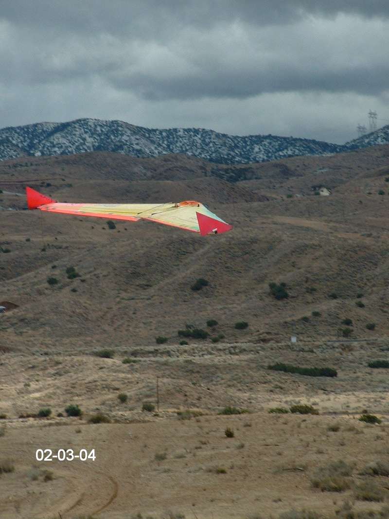

It's been done.
Here's my ZAGI 3C in a 20 mph gust 35 wind today... That's about about as fast a wind as it can handle.. any more speed and it goes downwind. (Froze my butt off! Note the white fungus on the mountain tops.. that's as close as I care to see THAT stiuff! )

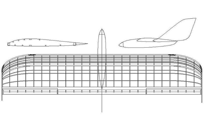

It's not a proven design yet but if you have CAD to look at a DXF file I'll email you the file so you can look it over for ideas for your own model.
