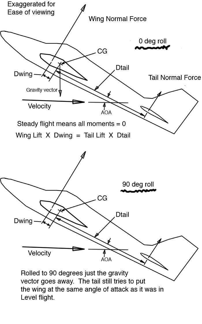

Diagram of rolled model forces
Posts: 1,406
From: St. Charles, MO
I promised I would make a drawing to show the normal forces on the airplane with roll. Notice that just the gravity vector goes away. The tail determines the AOA of the wing so keeps working on roll. Luckily most airplanes pitch to the belly so the normal force acceleration toward the canopy is never noticed. If you have no rudder deflection or a really pure airplane with rudder deflection the airplane will go toward the canopy at 1g acceleration. To stop it you must dump the elevator trim to 0 degrees

ORIGINAL: Ben Lanterman
"pitch to the belly".. what causes this "normally"
In a steady knife-edge configuration, the wing is still lifting, right? Unless the alpha is changed (using the elevator/mix) to eliminate that.
KE on my Kadet generally requires much down elevator to get the flight path straight due to pitching to the canopy (semi-symmetrical wing). Mac's hand-eye coordination is much better than mine, and can do a KE all day long with his Kadet.
Pushing the nose down in a longitudinal roll is common with a semi-symmetrical wing.
And the only way to get a roll out of a normally dihedralled RE airplane, which goes "towards the canopy" when rolled.

Don't mean to ignore gravity, if you are trying to do knife edge it is a big force. But it is in the Y axis of the airplane, along the wing. Assume you control the roll to 90 degrees with no rudder input.

I am impressed.
As your figure shows for normal rolls and low angles of attack with no elevator or rudder input the airplane initial roll acceleration is about the body axis but as the roll reaches steady state conditions (which is fairly quickly) the angle of attack is stabilized and the roll transfers to the velocity vector (of course with no elevator or rudder input the airplane comes down due to gravity)
When we do our rolls and input rudder and elevator we are forcing the airplane to roll about the body axis, which is hopefully at a low angle of attack to look really good.
A typical light aerobatic ship that will do high angle of attack (70 degrees or so) and hovering maneuvers can be seen to roll about the body axis in the maneuvers. In that case for a roll to the right that goes from 0 to 90 to 180 to 270 to 360 the angle of attack goes from 70 to 0 to -70 back to 0 and the sideslip angle goes from 0 to 70 to 0 to -70. Also the elevator is constantly moving to keep the airplane from transferring to a velocity vector roll.
