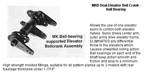

Old 02-27-2004 | 10:24 PM
Mike James's Avatar
Posts: 2,565
From: Anchorage, AK
Default RE: Split Elevator
Here's a part from MK, available through most Pattern suppliers.
Old 06-25-2009 | 03:29 PM
mike early's Avatar
Joined: Oct 2007
Posts: 2,106
From: Ashland, KY
ORIGINAL: Mike James
Can you believe these things cost 40 dollars?
http://www.centralhobbies.com/contro.../Bellcrnk.html
