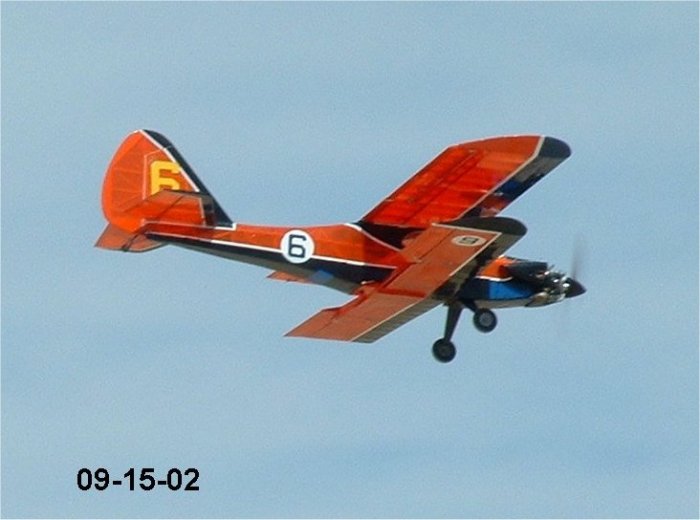

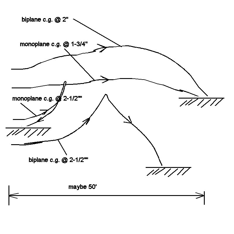

Alasdair, after looking into this stuff, I've come back to the graphical method as presented at the Palos r/c site as adequate, and figuring only the wings seen in the plan view as the parameters..
The attached Pitts demonstrates two items... I found a plan for a Pitts in Model Airplane News, March '95 which shows the c.g. at the leading edge of the lower wing.
The Palos method gives this same location for a 30% c.g.
If the "mean wing" is located between the wings per the areas, this ratio is about 97% for a typical Pitts.
Where does the "mean wing" then go?
Another method pointed out by acropilot_ty uses only the stagger between the wings to locate the "mean wing".
Using this method, which ignores area altogether, the "30%" point is always aft of the 30% point found graphically.
As I've mentioned with my biplane Kadet, the lower wing has a "setback" from the upper wing of 3", with a chord of 12" on the lover wing. Upper wing chord is 15"This places the lower wing area completely -under- the upper wing area; cannot be seen in a plan view. The plane can fly sans lower wing and no other changes.
Any method other than the graphical computes a c.g. way too far aft for stability for this biplane/monoplane.
2nd image as a biplane
3rd image as a monoplane.

Tall Paul,
Nice wee aeroplane. A homebuild I assume?
We can find the Aerodynamic Centre of a wing or pair of wings but no way can we discuss CG without knowing details about the tail. I know nothing about this aircraft's tail, so how about adding a tail and discussing the CG of my hypothetical 100% staggered biplane which you also drew and I have tried to upload here.[img][/img]
To sumarise, we have two identical wings, each 4" chord, section does not matter but I drew approx Clark Y, with 4" normal stagger, and a tail whose area is 15% of the total wing area and whose c/4 is 15" aft of the datum (LE of top wing). Let's say for completeness that the wingspan is 26".
Where would the CG go according to the method proposed and used by Tall Paul and others?
Too far aft I would suspect, unless a second error compensates for the first.
Alasdair
Hey, the image upload worked, thanks again!

The glider as monoplane balances at 2-1/2" aft of the top leading edge.
As the biplane, it balances at 3" aft.
The long tail has lot to do with the aftish normal c.g.
I'm going to do a tail-ectomy to get the c.g to 25% on the monoplane...
Moved the horizontal forward one chord... 3".. rebalanced as a monoplane to 25%.. 1"
Added the lower wing @ 4" aft, found the new c.g. without changing weight.. 1-5/8"
Glides well.

The wind quieted down, got to toss the plane for some distance.. the flight results are attached...
