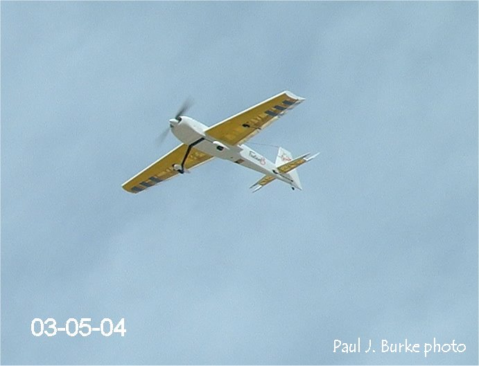

Old 03-05-2004 | 04:26 PM
Joined: Jun 2002
Posts: 5,211
From: Palmdale, CA
Default RE: Full span ailerons
Thinling on this, the TOC planes for example are required to be scale.
This means to-the-tip ailerons.
Now going to the full-scale world, the TOC originals compete for the big bucks!
If there were an aerodynamic (1st place money) advantage to truncating the aileron span, it would show up there.
OTOH, on planes where manuvering is the last thing on anyone's mind; big transports, outboard ailerons are locked out once the flaps go up.
The well-known torsional effect of an outboard aileron causing reversal in the roll direction could be countered by building a stiffer wing.
The MBA in Accounting that has the final design approval no doubt says... "Nope! Stiff costs money. Lock those ailerons."
Many of the more modern Goodyear racers I've seen use inboard ailerons for the same reason. All the plane has to do is fly fast, turn left. And not have a tip-stall while doing it. The more advanced planforms on Nemesis, Madder Maxx, even "No it's not a Shoestring" (Ray Cote was quite upset when I asked. ) feature inboard ailerons.
