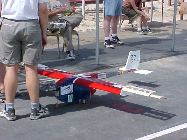

There was an SAE design with wing grid a couple years ago... my group thought about using them, but scrapped the idea and went with a 17.5 to 1 AR and whitcomb winglets... I really doubted those things and we didn't have time to do the research. The group that used wing grid had a very low aspect ratio wing of around 4 to 1 the plane crashed a couple hundred yards after takeoff... didn't carry much weight either.

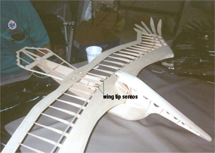

The SAE plane referenced above. It flew relatively well, I don't recall its flight score.
The pelican shown here has servo driven alules, which pivot similar to ailerons. I have noticed however ravens use their tails for directional control, tilting it in a manner similar to what free-flights do to get circling flight.
