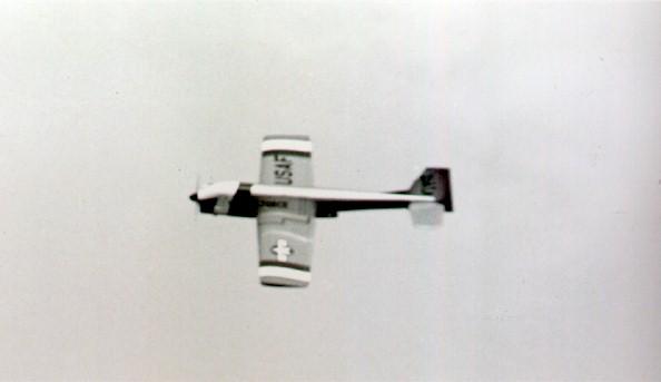

ORIGINAL: spadstick
camber control like 2 part elevator and stab has more control power at extreme throws than a full flying stabilator has. Jets use full flying because of supersonic compressability issues, in other words moving the LE becomes more effective then the TE.
I am no expert but this is what i've read on DJ aerotech, and i agree with what Dick is saying about too much Balance surface is not good either. I like mass balancing my tabs to lessen flutter tendency
Do you mean a full flying stabilizer like on this pattern design?
Old 06-06-2004 | 05:38 PM
Spaceclam's Avatar
Joined: Apr 2003
Posts: 4,643
From: chatsworth, CA
Default RE: Stabilators
i cant tell
Old 06-07-2004 | 07:58 AM
Spastic's Avatar
Joined: Jul 2003
Posts: 441
From: Buffalo, NY
Yes like that, but the amount of throw needed for pattern is less than for 3D, some small models get away with it, but IMO to do it on a larger model even a .46 size would not be worth it, there is an EPP electric foamy that has a full fly stab, it weighs 8 oz RTF its called the Blade i think
