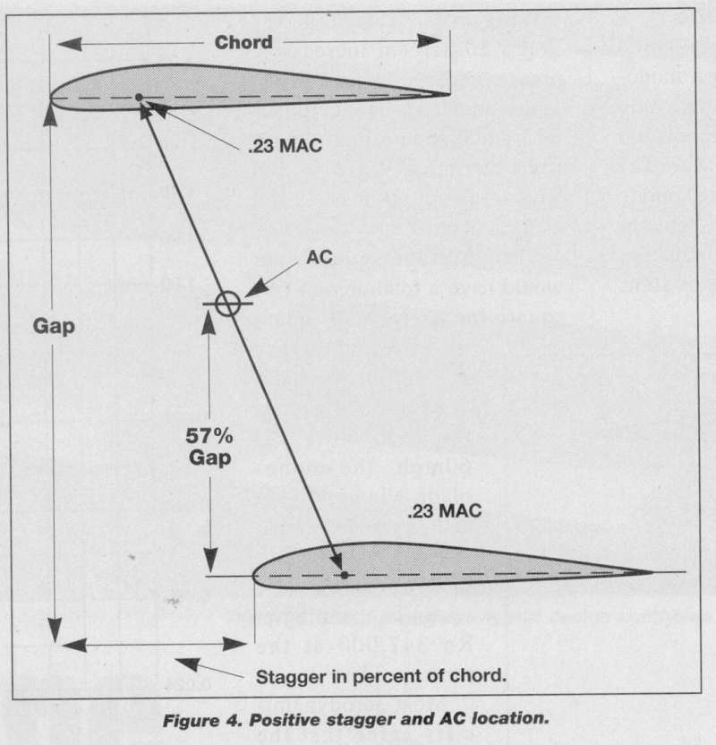

One of my clubmates (not into computers) has scratchbuilt a 1/4 scale WW1 Bristol FB2 biplane and now needs to know how to work out the C. of G. position.
Anyone out there got a practical formula or guide on working out CG for Bipes, taking into account stagger, differing chords etc?

Tall Paul had one of the simplest and most obvious rules of thumb. Look at the top view and do the CG as if it's only one wing with the area being only what you can see. Don't worry about the extra area hidden under the top wing. Only what is visible in a top view is the outline of the equivalent single wing. Assuming it's not an overly small tail it'll work as well as anything.
Besides, the FB2 had same sized wings with no stagger so the CG is the same as if it was a single wing.

Full-Scale NACA wind tunnel tests conducted in the 1920s and early 1930s indicated that the center of pressure of a biplane wing combination was located at 22% to 23% of the MAC (mean aerodynamic chord), compared to 25% to 26% for most monoplanes. The reason for this is not clear, as far as I know, but bipes need their CGs slightly farther forward.
