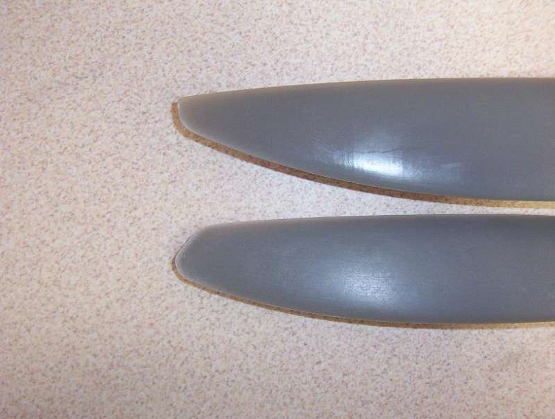

I have a 15 x 6 apc that I had to take 1/2" off the ends of to clean up a chip out. I wanted to keep as much as the prop as I could so, I changed the shape. The leading edge now is larger diameter than trailing edge. Will this be o.k.? Stupid question...Why is it alway the other way? What am I giving up. Please see uploaded picture. The top prop is 18 x 6 not modified and the bottom prop is my hack job.

It's not a good idea to clean up the damage from a prop strike, sir.
If you want to experiment with an undamaged prop that's one thing, but there could well be concealed damage to the blade that will cause its later failure in service.
It is your airplane and your engine, but it could be someone else's eye if the engine throws a blade while running. I'd cut both blades to nubs and use it only as a dummy prop when doing engine work, New 18" props are not expensive.

Thanks for the info. I do not intend to be careless and did not think that the rest of the prop would have suffered damage. If this was a wood prop or a master airscrew plastic do you trash the prop if the tip is compromised or is it just the APC?

I have to be honest and say my trashing the prop would depend a lot on how hard the prop hit. If it was just a buzzing from a slight contact I'd probably clean the tips as you did, but if it hit hard enough to stop the engine it's trash time whether it's an APC, MAS, or Zinger.
I will also admit a wooden prop wont crack without external evidence, if there were none it would be re used after a tip reshaping.

While I appreciate what Bill is saying it comes down to how it got scuffed in the first place. A model that noses over at idle and lower ground speeds and gently brushes the tip a number of times and gets a bit worn as a result can easily be saved. But a single strike that causes this level of damage is often reason to get a new prop. In particular if the engine was running above idle.
One thing I've noticed about APC's over the years is that as they suffer from impact or wear they generate whitish spider webb'y areas or single white'ish lines that can be seen in the grey surface. If you see any signs of that then it's time to retire it to paint stirring. I would check carefully around the tips for any signs of these white marks.
And with ANY APC I always make it a point to check the hub and blade roots at the beginning of the day. I've had multi year old props develop these white marks in normal use as well but it does take a few years.
And if this was a wood prop then I would suggest a new one immediatley. Wood props tend to develop splits along the grain and sudden stops are a prime way of doing just that, even at idle.
I ran a glow type 10x6 on a gear drive electric model that belly landed all the time. I would try to level the prop but it was not always successful. After a season the blades were very spider webbed from catching and bending but since it was operating at such a lower RPM (~5000) it didn't worry me but I DID make it a point to test it by test flexing it a bit now and then just in case.
So use a little judgement but if in doubt then I would get a new prop. An 18x6 is not an engine and prop combo to be trifled with.

I have never see a prop explode that was used after a prop strike if the prop was still intact. Show me one and I will beleive that I should throw away a prop that is not damamged, spider cracks and all.

If you will excuse me, sir, I would much rather not show you an exploding prop, thank you.
I shouldn't think you'd want to have one explode either. Those spider webbing marks are sign of excessive flex, leading to a fatigue failure.
It's a lot cheaper to throw one away than to have some one hurt.
Using a questionable prop is a good example of "Penny wise and pound foolish."

I totally agree Bill. Taildragger, we did have a guy's APC fail as a result of those spider web marks. I saw them and mentioned my concerns and he poo poo'd it as well saying it had been like that for quite a while. When I saw him next time he mentioned that it broke a blade right at the marks a couple of weeks later in a simple tip over at low throttle. I know it's only one but how much is an eye or more worth?

I had an APC 12x6 explode on my test stand. The prop had previously been mounted on a plane, but due to a prop strike on landing it shed the tip on one blade. I just cut it down to an 11x6 and only used it to run on engines on the stand. I was running an SC .52 at WOT, when it went bang a piece 2 1/2x5/8" pierced my shed wall (metal shed). I have my stand bolted to a black&decker work bench, the force and sudden imbalance almost topled the work bench. Now I only need to see 1 tiny dink in a prop and it goes in the bin.
