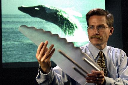

How about this:
Aerodynamic advantages of bumpy leading edges
After two decades of experimentation, including wind-tunnel testing, professor Frank E. Fish has come to the conclusion that the bumps confer significant aerodynamic advantages… the flippers with bumpy leading edges generate as much as 32 percent less drag and as much as 8 percent more lift than similarly sized flippers with a conventional smooth leading edge…
Scientific American magazine, August 2004.

That's a whale of a report!
Actually I wasnn't fishing for that kind of info but due to the carping and some crabbing I have had from various bank fishermen I guess that some casual blubbering is to be expected----

Hi Dick,
This may seem out of topic and rather controversial but:
Have you ever wondered why golf balls have dimples?
Just look at the leading edge of any Learjet and you'll find little machined diamonds attached nearby.
It is claimed to create counter-rotating vortices at either side of each leading-edge bump.
The vortices "inject momentum into the fluid flow, which keeps the flow attached to the upper surface rather than allowing it to separate".
Don't be surprised if you see some models with knobbly-knotty leading edges in the future…
Here's further source of information:
http://www.ascribe.org/cgi-bin/spew4...=2004&public=1
http://scitation.aip.org/getabs/serv...cvips&gifs=Yes
