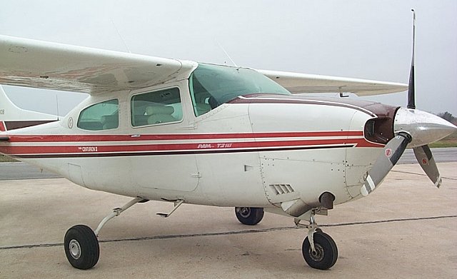

i have some club members who think by bending the very tip of the prop 90 degrees on the gws props creates more prop effiency. is this true? if so how much. i would think that if this is the case, all prop driven planes would have this.

Would this be an attempt to put a Hoerner tip on each of the 'rotating wings' on the prop? Such tips reduce the vortex losses, increase efficiency, etc. on aircraft wings, and maybe the proponents' rationale is that Hoerner tips would benefit a prop as well.

In FS airplanes, it's called a Q tip (Q for quiet?) propeller
Aerodynamic improvements include a reduced diameter and decreased tip speeds. This results in quieter operation and reduced tip vortices. The 90° bend reduces the vortices that, on traditional blades, pick up debris that can contact the blades and cause nicks, gouges and scratches.
Sounds like a marketing ploy to me
http://www.hartzellprop.com/product_...pport_faqs.htm
Cheers!

I can see their point with reducing the tip vortices, but not with a 90 degree bend. Thats not a very efficient angle to place it at. Also, props are designed to have the gratual taper from root to tip. This is the most efficient way for a prop to be designed (with today's information and technology). But an increase in tip speed, which would happen if you bent the prop 90 degrees, would generate a a bit more thrust, but I don't think that boost is worth all of the trouble and the saftey issues.

The benefit is real, both in noise reduction and efficiency gain, but the improvement in props in our RC planes would probably be mostly negligible. The reason 90 deg. bends aren't used everywhere and/or aren't bigger is the mechanical trade-off. Adding a 90 deg. bend creates significant CF induced moments in the prop blades, so you have to strengthen (read as thicken) the prop, which of course is not efficient- it's a trade-off that has to be evaluated for each design.
By the way, adding these bends to RC props is DANGEROUS for the reason described above. The props were not designed (the normal ones anyway) for the added CF induced bending stresses, so you risk prop failure by adding this bend.
DON'T DO IT!!!!!

I need to see a photo of one of these things...

ORIGINAL: Tall Paul
Old 09-23-2004 | 10:16 AM
mulligan's Avatar
Posts: 1,147
From: Sanford, FL
Default RE: Bending the prop tips at 90 degrees
I'll try again [sm=angry.gif]

That small difference at the tip makes a measureable difference in performance?
It might be possible in full-scale, but models are so seldom flown for true performance/efficiency, I doubt the alteration would be worth the effort.

http://tntlandinggear.com/store/shop...e_aircraft.htm
These particular props probably do not increase efficiency much (if any), and they certainly do not reduce noise levels, but they do add noticable stability in hovering-type maneuvers. This is due to increased prop normal force, according to an aero engineer whom I asked about it. I know I felt a HUGE increase in high alpha/hovering stability when I switched to a Prince prop for 3D.
