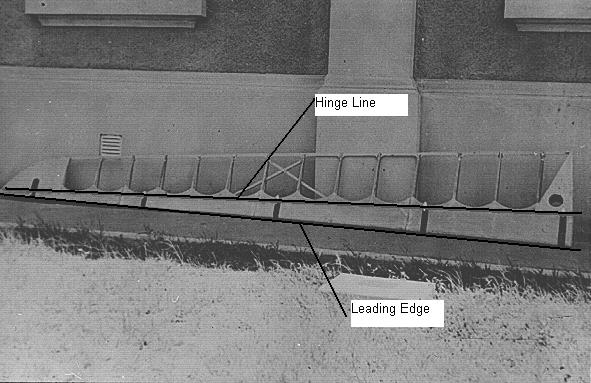

I´m begining to build my favorite plane. It´s a obscure 30's argentinian bomber called "AeMB2 Bombi".
Looking at ailerons photos, it is evident the hinge line isn´t paralell to that of aileron LE. I posted 2 images, one of uncovered aileron, and other of a finished Bombi.
At finihed airplane image, it´s very evident that when aileron goes UP, some part (inner) goes a little DOWN.
Really I don´t know why ...and if I build my 1/8 model in the same way ...how can this aileron setup influence flying characteristics.
Obviously I´m trying to build my model as scale as possible, and this includes ailerons setup.
Thanks in advance

I am not tracking on what you are saying.. from the image I see a tapered aileron.. But It looks like the LE of the aileron is straight.. Can you be more specific?

From the gaps at the root and tip for the aileron horns, there's a modest amount of "Frise aileron" effect, where the inner portion of the leading edge of the downward deflected surface projects below the surface of the wing proper, to provide a small amount of drag on that side offsetting the adverse yaw of the downward deflected aileorn on the other side.
Not commonly done, but not of any particular worry, if replicated 100% or not.

It was to combat adverse yaw just as Paul said. If you want true scale then copy it and it'll work for the model too. If you don't want to be THAT scale then just use regular aileron hinging but add in some differential travel where the up travel is about twice as much as the down travel.
This can be done either with the computer setup in the TX or with careful geometry in the control system.
With either it makes it a lot easier to do nice coordinated turns.

This seems to be more of an aerodynamic counter balance setup than a Frise aileron. Friese aileron sticks out the leading edge only when the aileron is moved up, but tucks it in when aileron moved down. From the picture, this looks like the leading edge of the aileron will protrude out of the wing in either direction of deflection. Kinda like modern Extra aerobatic airplanes - the ailerons are hinged at 25% of the chord and have mass counter balance in the leading edge (in addition to a spade that assists the movement and is used for trimming)

It looks like an application of aero-balancing to lighten the control loads & perhaps prevent flutter (those are huge ailerons).

It makes sence to me that the greatest load would be inboard where the aileron's chord is the greatest. And so they made the hinge point further aft (there) to lighten the stick loads.
As the aileron tapers and the corresponding load is reduced, the need for the recessed hinge point is less.
So why slant the hinge line ? You have to. The chord of the aileron becomes to small not to.

Actually who gets the cigar depends on the profile of the aileron. Paul's comment
"From the gaps at the root and tip for the aileron horns, there's a modest amount of "Frise aileron" effect, where the inner portion of the leading edge of the downward deflected surface projects below the surface of the wing proper, to provide a small amount of drag on that side offsetting the adverse yaw of the downward deflected aileorn on the other side. "
seems the most likely. That's the reason I asked about the profile, the Frise has a very definite look. There was a model in the early 1960's called the Orion that used them. It won the RC aerobatic nats I believe but no one else used them. For models it wasn't worth the effort.
