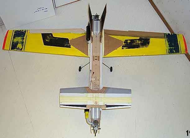

Phil and Jeff, thank´s for your replies, I feel more confident now and will proceed with one aileron but make it full lenght on the right panel. Attach photo of current plane, she will be equipped with a piped MVVS .49 rear exhaust engine so I think she will be pretty quick.........Cheers/Harald

Guys, just to let you know that the pylon ship has now flown successfully for a season with single aileron control and it works pretty well. Again, thanks for your support. Yes, she is a bit sluggish when rolling as you warned about Jeff but landings do not seem to be a problem even considering that I ended up with less than full lenght aileron(about 2 inches left solid in the tip) on the right side. With new paint scheme she looks like this..............;-)....Cheers/Harald

Hi Mel, here more pics on the push-pull canard.Bit the dust two years ago......Cheers/Harald

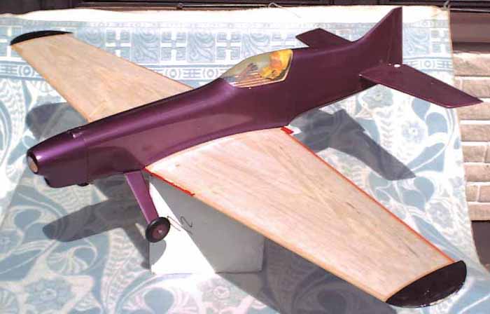

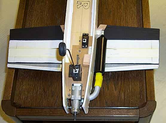

Attach photos to show the new ship which has progressed quite a bit since they were taken. Maiden flight planned for next spring.A thinner wing and retracts to give even more speed.................Cheers/Harald
