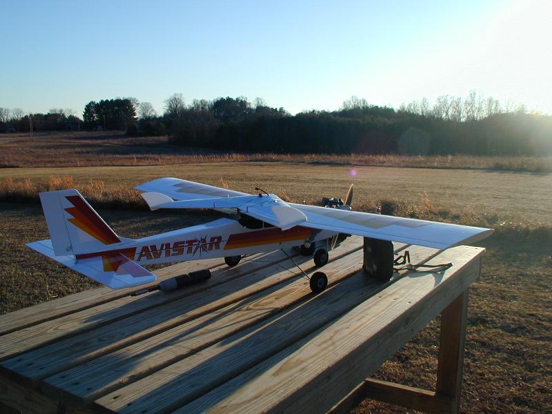

I built mine with two servos in the wing from the get go (arf version, not the ready to fly version). I learned to fly on it, and then started playing with flaperons, air brakes, etc. I would say, 15 degrees max on the flaperons works well, but it gets very tippy, as said in previous posts. I think you would be better suited to set up the air brake function on the radio, giving about 10-12% of down to assist in takeoff. I would actually attach a hand launch zagi wing on the top of the wing, used wing bolts instead of rubber bands (again, right from the start of construction).
It will tend to make the plane very jumpy on final approach, given the increased surface area that is moving, so stalling is a very great possibility.
The last setting we had the most fun with, was using flaperons, and setting the airbrake to turn the ailerons upwards, pushing down on the wing, and it would just suck itself down to the runway. With flaperons, it would also do the tightest loops, so make sure you glass your wing, so you dont hear the dreaded POP!!!.
The pic is with the zagi on, before I enlarged the rudder to about double original size. It would pull the zagi up with an la 46. That plane saw many different motor combos, including an la46, supertigre gs 45 (rocketship with unlimited vertical), and a ys45 (more rocket, more vertical)
And yes, those zagi wings are available as a kit if someone is interested. all up weight with servos and battery is about 2-4 oz.
