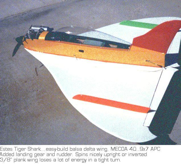

I put the landing gear on my Shark because of the fear I had of handlaunching something that powerful.
That plane used a 5/16" sheet balsa wing, with an elongated S-curve for camber; essentially a drooped leading edge and reflexed trailing edge.
It was c.g. sensitive, and managed to spin in all by itself, both upright and inverted.
